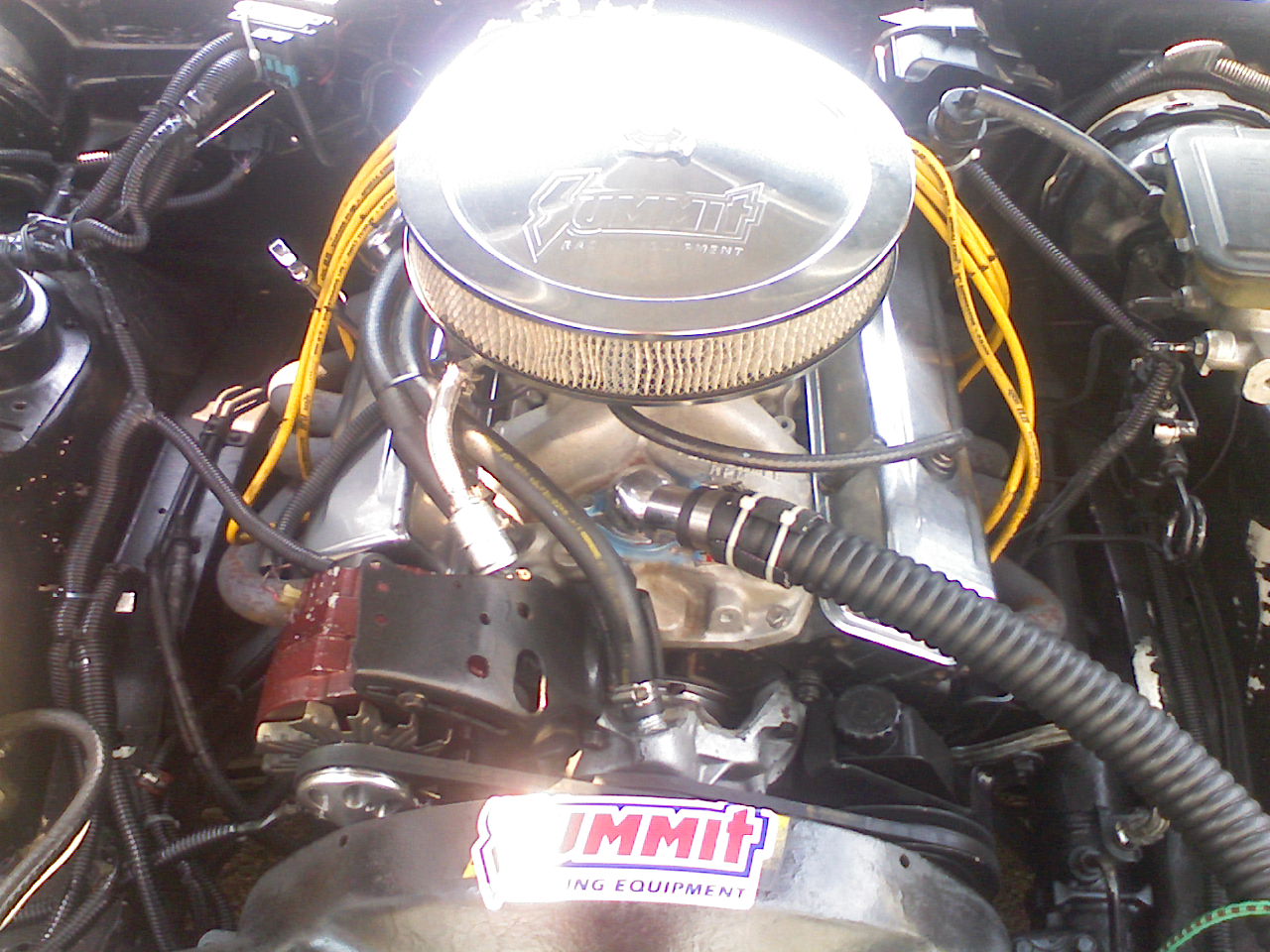

here are three pictures 2 of them are the motor and one of them is my 305, you can see the dirty one(the frankenstein motor) is clearly bigger lol, im pulling it out probably tomorrow

looks like an sbc with late center bolt heads.
All sbc's should be the same size but aftermarket blocks can be had with a taller deck that'll make the whole motor wider.

CLT is a 73 350 block. It's not hard to put center bolt valve cover heads on an early block.
Getting the casting number from behind the driver side head will probably only indicate that you have an 010 block.
Pulling a valve cover to get a head casting number will give information about the heads.
