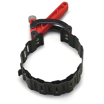

Did it look like this?
If so, toss it in the trash.

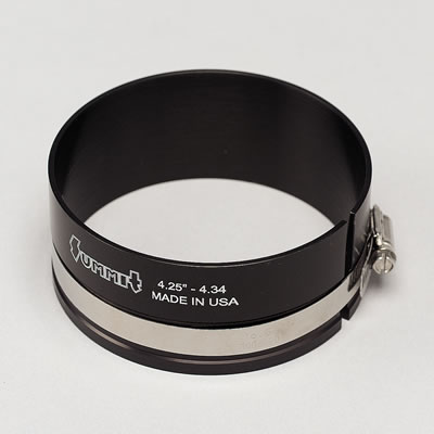

Try a set that looks like this
or this
Make sure you keep it tight against the block as you push the piston in.

Originally Posted by keeslinger31
just curious whats wrong with the first one i havent ever installed pistons. sorry for the noob question
The steel band overlaps itself so it's not perfectly round on the inside, you need about four hands to tighten the band while you keep the rings in their proper locations, the edge of the compressor easily slips into the bore, or the edge of the ring slips out and gets caught above the bore.
I used to use one of those. I ended up buying a bore specific one of these and kick myself in the *** for not getting one sooner. They work great!

I wouldn't mind having a whole set of fixed-size compressors like that.
These don't look too bad:

The ring my neighbor chipped using the POS band style clamp ended up costing more than the correct one bore size only tool. The pistons drop in like butter. Best $25 I ever spent on an engine tool.

I have always used the one in the first pic with no problems... I have built a ton of motors using that style... One trick to using them is to make sure the piston is square in the compressor... tapping the sides with a wooden hammer handle works to getting the clamp to tighten up evenly...
