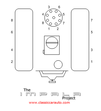

Originally Posted by mathandler
As I said in the post SOMETIMES the firing order will change with a different cam. Usually not but some do!
How would a cam change this?

Just to be clear I wasn't being sarcastic, I was really wondering. Looked back on my posts and was like wow, I sound like a d*ck lol. I did not know you could reverse the order that valves open by the lobes, but I guess it makes sense in my head. I need an asprin now as well, thanks guys.

The distributor being off a tooth doesn't do anything but change the position of the distributor housing. The exact location of the spark plug wire on the cap with respect to the engine (as illustrated in the attachment - it's actually one terminal clockwise from the typical factory delivery) doesn't mean anything - it's which terminal the rotor is pointing to with respect to the piston/cam position.
Most likely you've got the distributor installed 180 degrees off.

Holy crap I didn't even notice that in the pic I put up. Bet you trust me a lot building my own motor now huh five7kid lol. I'm .
