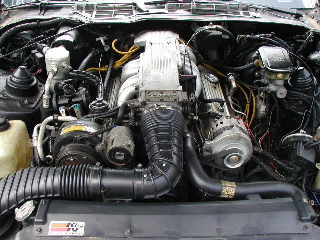

2 hours is right for a carb engine in a "clean" engine compartment.
I think he's right on the money with the 4-5 hours if your engine looks like this:
and he evacuates and recharges the A/C.

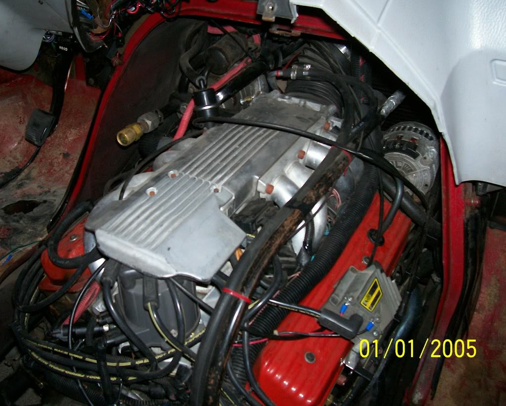

My engine looks like this and I put roller rockers on it in under 2 hrs time. That included removing the a/c compressor as well.
I will also say that they are IMO 100% worth it even for a street engine. I noticed the difference immediately. Even the idle note changed slightly more deep. I had to add more fuel almost everywhere, especially at the higher MAP end due to increased air flow. My rockers fit under a set of stock covers that had been lightly trimmed at the contact points.

My engine looks like this and I put roller rockers on it in under 2 hrs time. That included removing the a/c compressor as well... My rockers fit under a set of stock covers that had been lightly trimmed at the contact points.
We were talking about full-roller rockers. If you got full rollers under those covers, you need to post a pic so people will stop throwing away their money on aftermarket valve covers that don't have a damn filler cap to pour oil into the engine.
(I checked, sure enough, out of 218, only 6 had a filler (and 2 of those didn't include a CAP!))
I think we should take up a collection to get you a 3rd gen body to play with. I have yet to see someone have so much fun with a TPI in a van. (love the burnout video) I'd bet with an F-body you would build something very impressive.
Get the narrow body, self aligning, full roller rockers and they will clear the stock covers with a slight trim to any impeding internal bracing. I had none. The pushrod holes in the stock GM Goodwrench 187 casting 305 swirl ports that are on my engine were even big enough to keep the pushrods from rubbing. I also ran the same 1.6:1 full roller rockers on my Goodwrench 350 TBI with the same results. I have more than one set of these rockers and will take a picture when I get home this evening just to confirm we are on teh same page.
