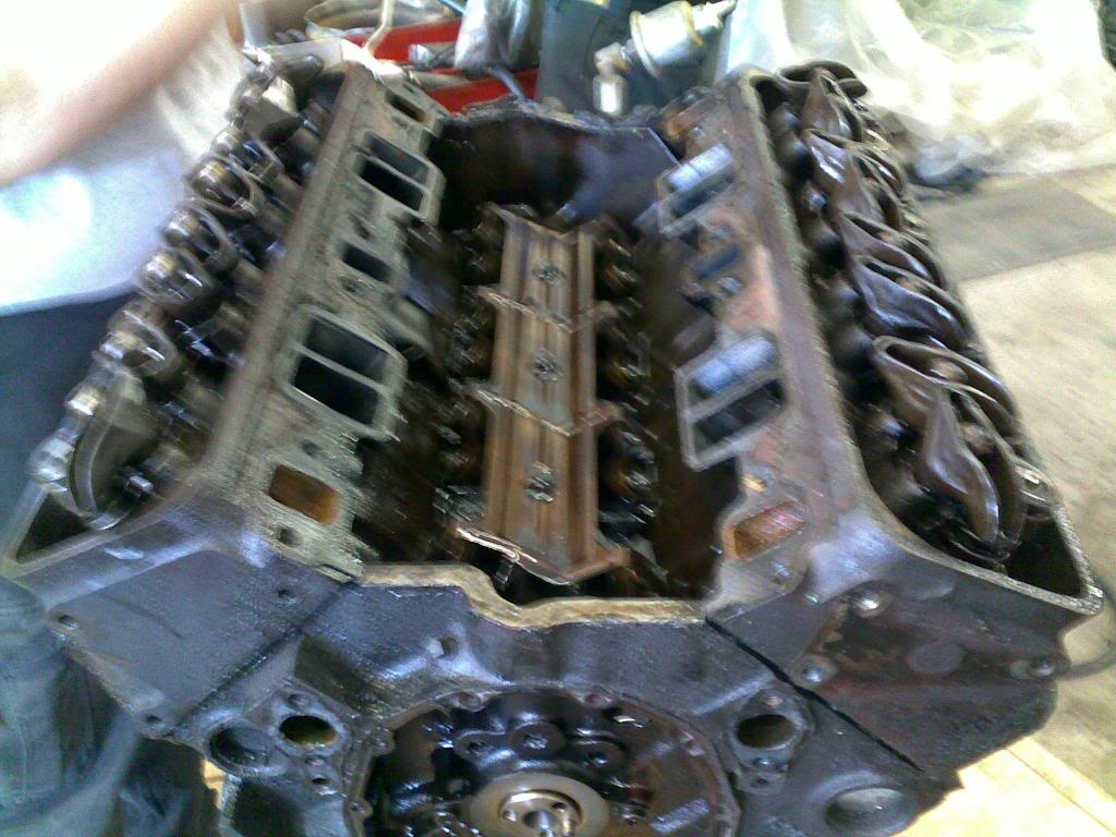

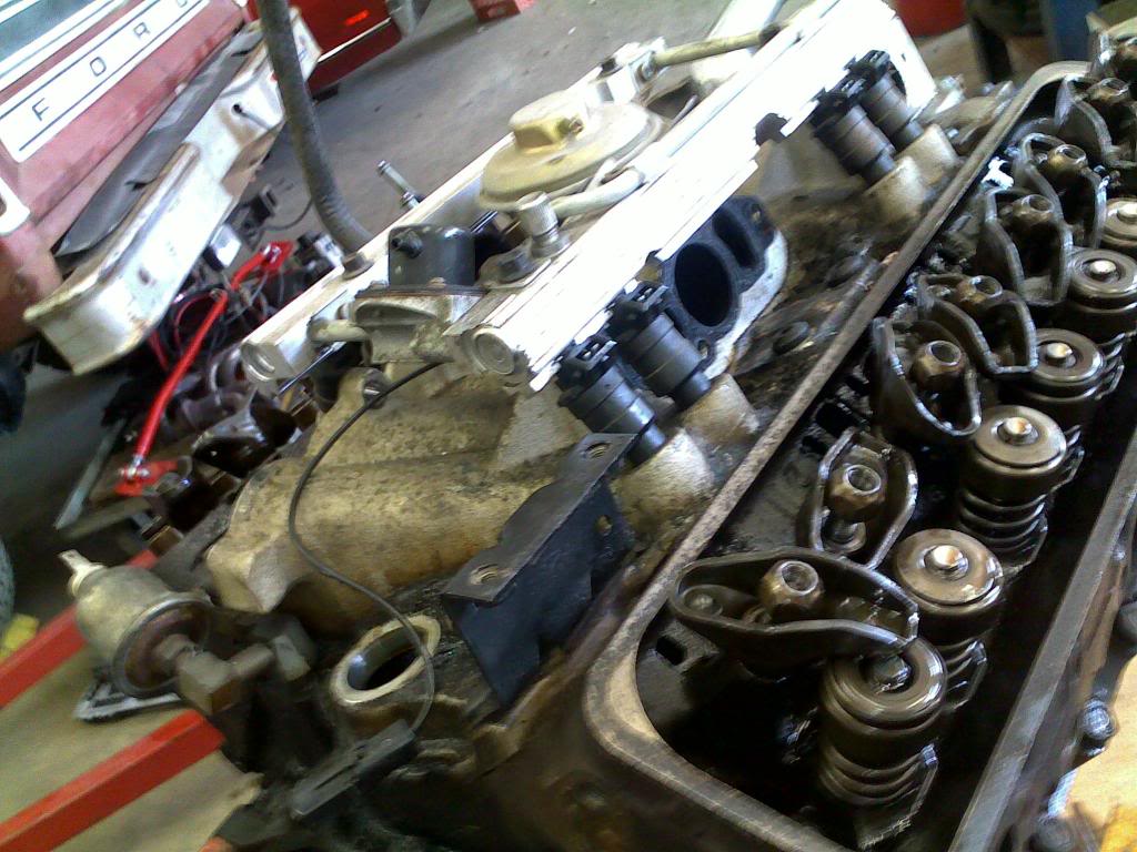

sorry for some fuzzy qualitty pics taken with my nokia e71 phone
promlem i found in my engine bay.......
http://s193.photobucket.com/albums/z...urrent=198.jpg
and then their are more on photobucket....
Joined: Mar 2000
Posts: 43,187
Likes: 46
From: Littleton, CO USA
Car: 82 Berlinetta/57 Bel Air
Transmission: 4L80E/4L80E
Axle/Gears: 12B-3.73/9"-3.89
Metallica chips in the engine compartment - definitely not good.
Same block I've got in Berlinetta #1. Started off life as a ZZ3 crate engine, so it has 4-bolt mains and pink rods.
Had another one that was taken out of my brother's '92 Suburban, but it was 2-bolt mains, flat tappet lifters.
A decent block upon which to base a performance build.

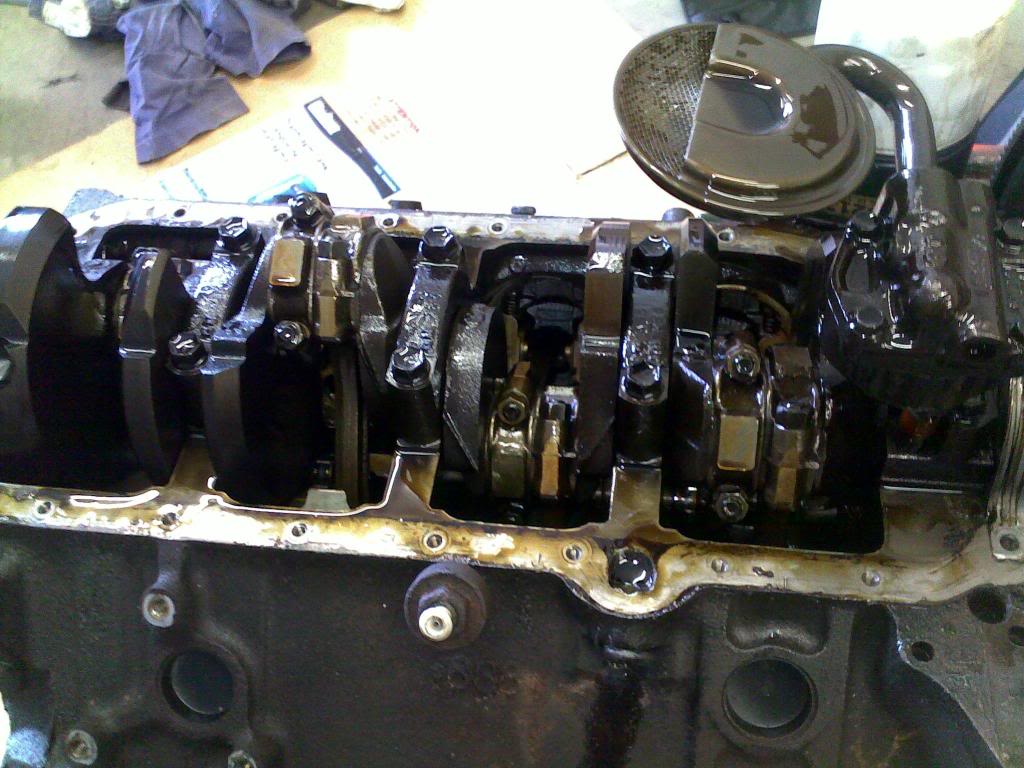

before the swap
internals
