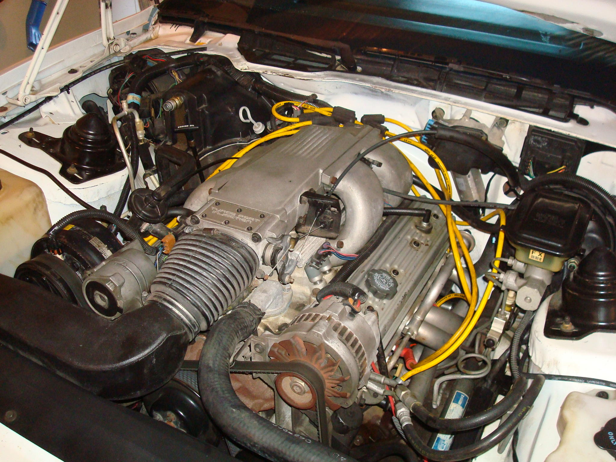

i bought a gta from someone that could not get it to run! it has been sitting for 4 years
they broke the coulum and the ignition out..the key was broke in half..
i changed the coulum and had a new key made to fit the vats set up ..
i learned the new key ,and tried to start the car and i have nothing !!
i jumped the starter and it cranks ,but when you turn the key i have nothing,,changed the neutral safty switch,and the relay at the kick panel.and even tried a working ecm ,you hear the fuel pump kick on ...
anyone have any ideas? i tried everything i could before i posted this thread,,googled the crap out of it!! here is the car

Its all good now...finally got some time off of work to d=ck around with it some more..
the neutral safety switch was not in the correct spot,,,kicked right over...
best 1,000 bucks i ever spent ... 91 green gta with 80,000 orig miles..
Thanks for all your help!!!
