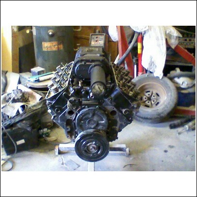

You have a nice car. I have a 87 TA 467ci 174 supercharger th400 moser ford 9" 3.55 minispool. all in the floor.
I did run it 3 years ago with the wrong head gasket it vaporlocked really bad. it had the th400 and stock 9 bolt 2.73 gears and a old pair of nova headers cramed in there with a single 3" EX.
the car ran 7.7 in 1/8 with a soft launch didnot want to brake nuthin.
this is still a full street car.

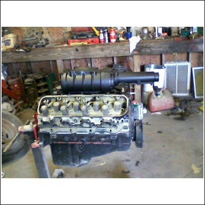

I bilt my brother a 453ci 440 for his 4000 pound charger 12:5cr 399hp nitrous LOL 7.40 on motor street car. runs on e85. we blew out a felpro gasket went with a whut we were told by summit was a titan ics coper gasket. well we blew that out to. then i relised it was a coper gasket not titan we O ringed the block and have no problem now...
Well with my TA i want to skip all that and get a good gasket.
But that gen 5 block is hard to work with thay changed the water ports with the deck. I got mark 4 rectangle port heads i want to use.
You got 14:1cr you blew that gasket that can only handle 12.5:1cr to 13:1 safely.
with my B&M 174 supercharger making 5 psi of boost that i had last time i ran it. befor i restriped it. With the stock cr of 7:1 + boost it made 13:1cr at full boost by the B&M paper work. but now i have 10.2:1cr + boost that is 16.2:1cr
scarry i now but whut the ell i will try eney thing to catch that charger that I bilt..
