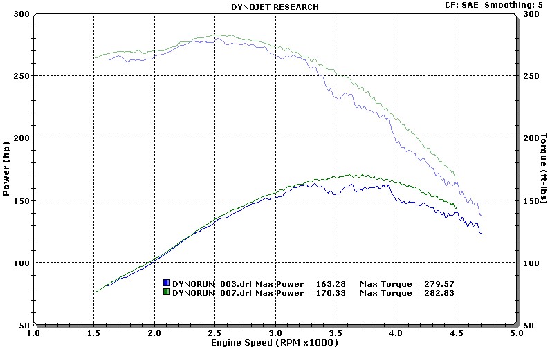

I've done a very similar build, an '84 Camaro with a CC-carb 350, stock converter, 700R-4, 3.42:1 open, and 235/60R15s. I tried the Summit K1102, and it was down on low-end torque, I couldn't even spin a tire, and the computer really didn't like it. Watching my tach, I determined my converter was stalling to 1500 rpm. And that cam is really mild: 204/214 at .050" with a 112 lobe sep and .420/.442 lift. For your combo what you gain in compression you lose in rear gearing. Mine felt great from 2000 rpm up.
I dyno'd it on the stock programming and L69 chip. Its sad that the Van tuning was hotter than the Monte SS L69s.
As far as running the 305 CCC Q-Jet setup on a cammed 350, I did that as well. LT4 (203/208 @ .050) roller cam in a 350 with Vortec heads, ran GREAT.

Just for the record - I have run the K1103 (or the gmpp version of it, same thing), and the XE262 back to back, when the first cam wiped out. Nothing else changed - 350 with crap 624's, 7004r4, 2.77's, no headers - the difference was night and day, far more bottom end AND top end.
From memory, the K1103 has about 70 degrees overlap, which I understand would play havoc with the ECM.
