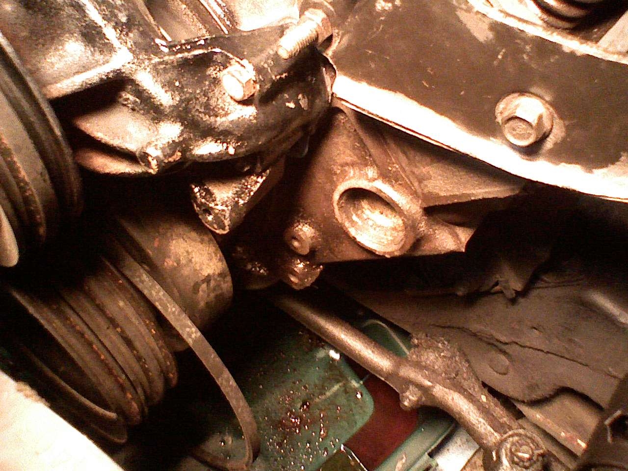

Ok I got everything except the two bottom holes on the block- what is supposed to go there?

well on these '80's style usually nothing bolts to the engine block using these two holes.
the p/s pump brackets setup bolts to the water pump flat spot on the driver side one bolt hole hole threaded there in the pic,
top threaded stud in cylinder head by the water pump mounting bolts there
also using the first exhaust manifold first bolt stud that holds the adjuster slot bracket in place
and using the bracket between the lower a/c compressor and upper p/s pump setup
have fun

Thanks I've been going crazy trying to figure out what went in those holes
