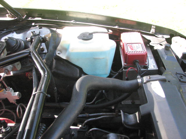

Mine is up front over the vapour canister. I bent up a piece of sheet aluminum for a base.
So far no overheating issues.

Not bad I like that setup. Does it have to be a certain distance from the coil and dizzy?
Old Jun 15, 2009 | 08:36 PM
skinny z's Avatar
Joined: Dec 2005
Posts: 9,931
Likes: 892
From: 53.0907° N, 113.4695° W
Re: MSD location???
Just within length of the premade harness.
