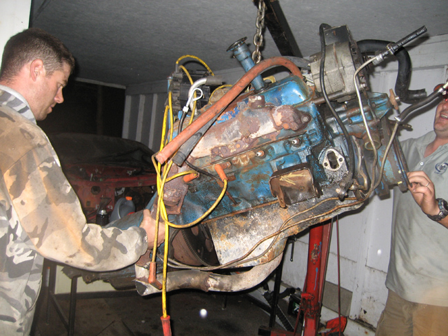

So I have all my parts and my tools ready, I got my lift and I want to raise the engine up slightly so I can actually get to the oil pan and change it (Cross member is in the way and pan is hard to reach). I have never hooked an engine up to a lift before so I need to know where exactly to hook the hoist to...and what with ?? I also need to know what if there is anything in particular I should look out for when doing this, and also if there is anything that needs to be removed (I will take distributor cap off to make more room near the firewall). If anyone has done this before a few tips would be appreciated. The engine is a 305 TBI.
Thats for tomorrow,and I will take some pictures of the work.

Well becides the distributor cap its theres nothing to take off really. To hook the motor to the engin hoist use some heavy chains and use the chain links that actually close up not like thoes "s" shaped deals they will bend and break. For where to hook it to the motor there are points to hook to on the drivers side front of the block and the passenger side rear behing the valve cover if im not mistaken.

Okay so this weekend went well. As with any project like this, you always run into things that set you back. In my case it was rusted fasteners. If you think about it, jobs like these would go really fast if everything came off and went on in a smooth manner; in an ideal world though, especially in Canada where we have a lot of rust problems because of the weather.
Anyways so the only thing that I did not get done is the sway bar links. I got the sway bar off and links cut off ha ha cause they were so rusted, now I just need to sand blast the bar and brackets, paint it, and re-install it with some new links Should be pretty easy !
So, I got my car up onto some ramps. Note, I discovered how usefull a creeper is this weekend, its hell try to sqeeze yourself underneath the car and back out when you need a different tool, so I bought one for next weekend.
First thing I did was get the flywheel cover off and clean it. Then I removed the starter motor, carefull when taking off the wires (also don't forget to take off the negative battery terminal !!) I then drained the oil out of the damaged oil pan and I took the oil filter off. In order to take the oil pan off you need to remove the muffler too which was hard. I needed 13" of extension with a flex elbow on the end to get in there and reach it. That took a while to get off too because the bolts are always so rusty. I eventually got it off though.
The old starter motor was caked in mud and rust, as well as the old oil pan. It is obviosu that the previous owner hit a rock or something which was hard enough to dent the crossmember and hit the oil pan right were the drain plug is. This made a hole in the oil pan, car will hnot hold oil, leaks all over my driveway and is a pain in the ***. Previous owner tried to fix it by smoothering the oil pan in Bondo which did not work, but made getting the oil drain plug out a nice challenge ! The car also did not turn over very well and we could not move the car easily, so we suspected the starter motor was weak. Upon getting the old motor out we realised that the solinoid was done and also that the wire connecting the solinoid to the motor had been broken off and was hanging on by only a couple of strands (which would explain why the motor was not cranking very well !

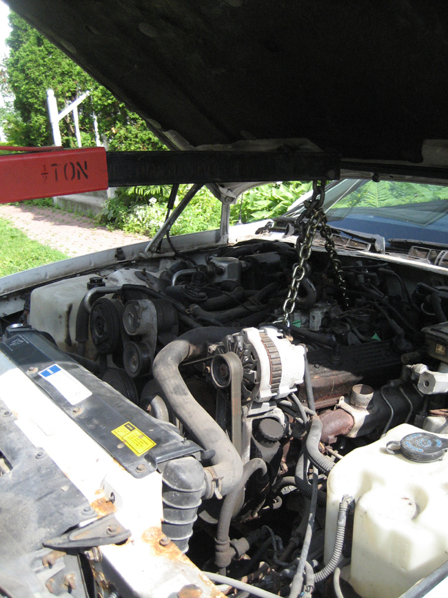

After that I removed the transmission crossmember bolt and 2 motor mounts. Then I chained up the engine using the the two engine hoisting loops (which I did not know were there until someone told me ha ha!). Moved the hoist into position, hooked up the chains. BEFORE this though I took off my distributor cap ! You need to do this or else it will hit the firewall when you are angleing the engine up and will break the cap. Then I started cranking the lift and got the engine up high enough so that I could get at the oil pan.

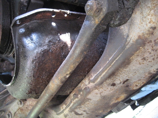

This is where I ran into some set backs. Most of the pan bolts came off nicely, however 2 of them were so rusted the tops of them just stripped right off. 2 hours of awkward and difficult grinding of bolts...and teeth followed; with a grand finally of loud cursing and shouting and the stupid oil pan. There is nothing that frustrates me more than bolts that strip out.
So in the picture you can see me there trying to ge tthose bolts off, they finally came off though !
Set my timing mark to 6 oclock, since the crank needs to be there for you to wiggle the oil pan off. Then off comes the old gasket. Insert new gasket and oil pan, button that all down. Re-install NEW starter motor and re hook the wires after giving them a nice little cleaning. Install new oil filter and start putting some new oil in. Re-install muffler, note...very difficult with only one person and took me way too long fumbling around with a shortage of space and patients! Re-install snorkel assembly and changed my air filter while I was at it.

Attached Thumbnails Got to get this 91 and 92 RS on the road in 3 weeks !-lifting-engine-thirdgen.org.jpg   Got to get this 91 and 92 RS on the road in 3 weeks !-bolting-chains-together-2   Got to get this 91 and 92 RS on the road in 3 weeks !-rear-motor-lift-ring

In these pictures you see the damaged oil pan with bondo. Me grinding the stripped bolt head on the oil pan. And how dirty you get if you don't have a creeper ! It is also way to hard getting underneath the sar with almost no room at all.

Here you see the clearance you need to get the oil pan off, I should have had even more than this but i scared to crank the engine up any further and put stress on hoses etc. My two little helpers, one more of a nuisance than a helper though, but both pretty cute

Okay so DONE and everything runs great. This wendesday will be the sway bar link repairs. This weekend I am going to be taking a break from the white RS and moving on to my green RS.

Okay so here are some updates on the current cars. A few things have changed. Upon COMPLETELY stripping my Z28 down to the basic chasis, I have learned a lot about these cars. I don't think there is any component of this car that I don't know about know. Everything from electrical, steering, interior, engine, doors, transmission, drivetrain, rear end, to trim. I have taken apart everything and the process has taken me a few extra weekends but it was worth it.
I have been selling the good parts off the car as I am going, and in this process I have made a few new friends who are also working on their Camaros in the city. I have this guy that come down from Kingston Ontario to help me every 2nd weekend now and he has become a good partner for this kind of work. I have been giving him the parts that he needs to complete his 83 Z28, and in return he has been givingme what i need, plus helping out a whole bunch. I gave him a bunch of parts plus a TH350 transmission which he wanted.
In return he is hooking me up with a rebuilt 350, complete dynomax exhaust, and Z28 rims with brand new tires intalled and balanced, which is awesome because I need brand new rubber badly. So this last weekend I pulled my engine and transmission from my car, the old 305 truck engine. There were a few new suprises. The exhaust was a hastily put together piece of crap, so I ripped all that out. As well, the transmission crossmember was welded to the frame . Gawd! Getting the hastily installed engine out of this car was an ordeal upon itself. Faced with cramped working environment, i had to cut the muffler off, AND the crossmember ! Sucks.
Anyways, here are few pics of me getting the engine out. Just a note to others who are doing this...make sure not to be an idiot like me and drain your tranny fluid before you take the driveshaft out of the back of your tranny. My landlord is going to be thrilled about his driveway ha ha!
So for this weekend...install the complete dash and gagues from my 86 into my 92, lots of body work, electrical and wiring harness install to get prepared for my new engine being delivered in two weeks.
Attached Thumbnails Got to get this 91 and 92 RS on the road in 3 weeks !-engine-removal-1-f.jpg   Got to get this 91 and 92 RS on the road in 3 weeks !-engine-removal-2-f.jpg   Got to get this 91 and 92 RS on the road in 3 weeks !-engine-removal-3-f.jpg
