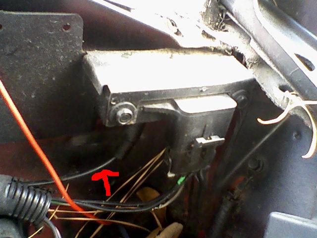

i could only find one of the smaller outlets you were talking about (see attached piture)
it split into two: one was quickly drawn into a closed wiring harness and the other ended at the corner of the engine bay closest to the windshield on the driver's side (see attached picture). i don't even know what this is to be honest
Joined: Sep 2002
Posts: 9,192
Likes: 20
From: Cary, North Carolina
Car: 1992 RS
Engine: Carbed 350
Axle/Gears: 3.42 posi
Re: 86 350 4bbl Burning Oil From Valve Cover Breather
OK - not sure what to tell ya - I'm no Holley expert.
Either call Holley at 1-866-GO-HOLLEY, or ask on the carb board.
You want to know which vacuum source you can "T" into for a PCV valve.
