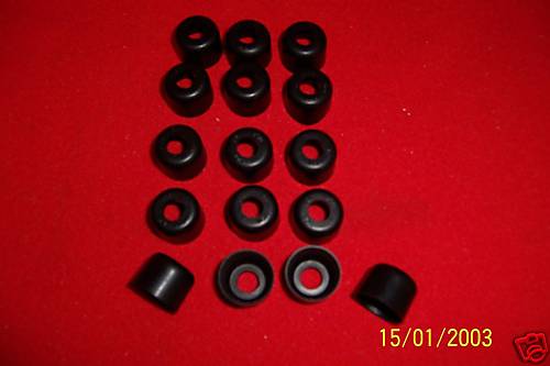

So I'm in the process of doing an lt1 cam swap in my 305 and bought new valve springs and an engine gasket kit to go along with the cam swap. I'm a little confused about the exact order of what goes where when putting the new springs and valve seals back on the head. I've attached pics of what came with my gasket kit, any help would be greatly appreciated.
Attached Thumbnails help installing valve seals-head.jpg   help installing valve seals-cimg2740.jpg

Throw all of that away, and get some positive seal viton seals for all the intake and exhaust valves.
Old Jul 28, 2009 | 09:00 AM
tony_cogliandro's Avatar
Joined: Sep 2006
Posts: 1,531
From: sunny so cal.
Car: 1990
Axle/Gears: stock
Re: help installing valve seals
i agree. usually you dont run positive on exhaust but you can if you fix them,
put the ones on the INTAKE and what you have left over will be the exhaust. the intake are supposed to be tight - oil in the gas is bad.
but the exhaust need oil so AFTER YOU PUT THE INTAKES ON so you cant mix them up, run a rat tail file through the exhaust ones so that they are not as tight.
then you are good to go.

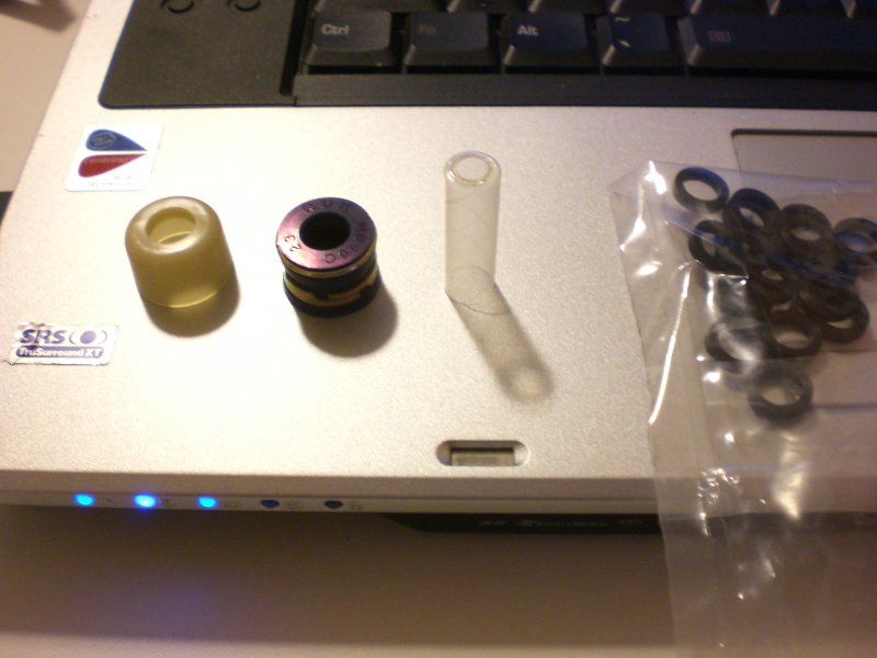

Reviving an old thread because it's the best one I found for my problem. I just installed 16 valve seals incorrectly. I installed the little "o" rings BELOW the retainer, but they should actually be ON TOP of the retainer.
Heads are on the car, and I think I might leave them as is because it looks to me like the seals (Fel Pro) are doing most the sealing job, not the "o" rings. The question is: What are the consequences going to be for ignoring my mistake?

I really don't know why the top o-ring exists. There's nothing to seal there.
If I recall a set I bought had o-ring for under and above the umbrella. I could be mistaken but I'm sure of it. I did however switch to all rubber. And I'm not 100% sure I have every o-ring above the retainer either because I believe I put them on before I compressed the spring. I'm not going to let it bother me because the stem seals are doing the job I intended. I do not recall another motor I have worked on where I put o-rings under the keepers.
Just my tuppence tho'.
Old Feb 26, 2011 | 02:43 PM
eseibel67's Avatar
Joined: Jul 2009
Posts: 2,328
From: Kitchener, ON
Car: 1988 GTA
Engine: LB9
Axle/Gears: 3.45
Ya, I don't remember any other valves that use this setup either. But I asked a guy I know at a machine shop, and he says the purpose of the "O" ring above the retainer is to reduce the amount of oil running down the valve stem and onto the actual seal. But you can live without it, also.
But since I'm so ****, I took them all apart again and installed them properly.
