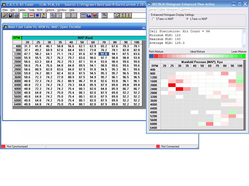

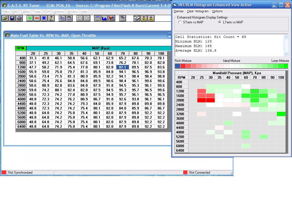

Computers can pump all the fuel the cam could ever need. It takes time to understand how to program the computer to match the cam. With a histogram, you can very quickly figure what vacuum is rich or lean.
100 Kpa = Open Throttle
20 - 30 Kpa = Idle
dave w
20 - 30 Kpa = Idle
dave w

Originally Posted by v10viper04
Again.... if the car cannot make the amount of vacuum necessary the computer cannot figure out the timing therefore the car will always run like crap.....
I've programmed several PROM chips. The fuel map for each vacuum RPM cell needs new values programmed into each individual fuel cell vacuum map. No it's not easy to change all the individual fuel cell vacuum maps! I've done it, and radical low vacuum cams can be used with EFI! Want to go to the race track with me and let me PROVE IT?
dave w
I'm sorry i didn't know you were an expert with 54 posts..... Sorry man, my bad.
Not a big deal. I don't really have much time to spend on web tech boards. I thought the screen shots from my TunerCat software ( http://www.tunercat.com ) and my DataMaster software ( http://www.ttspowersystems.com/DataM...downloads.html ) was an indicator I had tuning experience.
dave w
