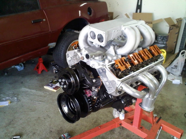

Well, my new engine is almost complete. My Harland Sharp rockers are not fitting with my AFR's because I think I may need new rocker studs. Otherwise, it will be installed tomorrow.
What do you think? What color valve covers do you guys think I should go with?
Attached Thumbnails New Engine Nearly Complete!-1004091504.jpg   New Engine Nearly Complete!-10040916599501.jpg

Are you running a tubular K-member?

I have the stock one right now but thought about going to a tubed k-member. Why do you ask?

I do not have a build thread but can give the basics below.
350 bored .04
Eagle rotating assembly balanced and polished
Speed pro pistons (flat top)
Zero decked block
AFR Eliminator 180 heads (65CC combustion chambers)
LIngenfelter/Accel high flow intake and runners
.041 Fel-pro gaskets for a .041 quench
Hooker headers (ceramic coated)
Double roller timing chain
Lingenfelter 74216 cam
Harland Sharp 1.6 roller rockers
Custom chip by PCM's for less
TCI streetfighter transmission
B&M hole shot 2,400 stall
All aluminum radiator
I think that about covers it!

Ok, fine make me go look for cam specs.
213/219 .493/.502 HR112
Decent lift, i'd like to see some more duration, should be very "streetable". I'm guessing about 420hp.

LOL, sorry I guess it would have been easier for me to post them. I would like for a little "lope" in the exhaust tone but I am not sure I will get it with this cam. Streetable is the goal though as this will mainly be a fun weekend car.
The Harland Sharp rockers through me off though. I thought they would go right on, but I do not have enough thread to get the poly locks on. I guess the trunions are too large and I need larger studs. I am going to call AFR in the morning.
That would be great to have 420 HP. I was hoping for 350 to the rear wheels, so with parasitic loss I should be right around my mark.

The reason I asked about the tubular K-member is that from the photo the drivers side header looks like it will go right through the factory K-member. It could be just the angle of the photograph.

Those are hooker 2460's and they fit just fine on my stock k member car.
