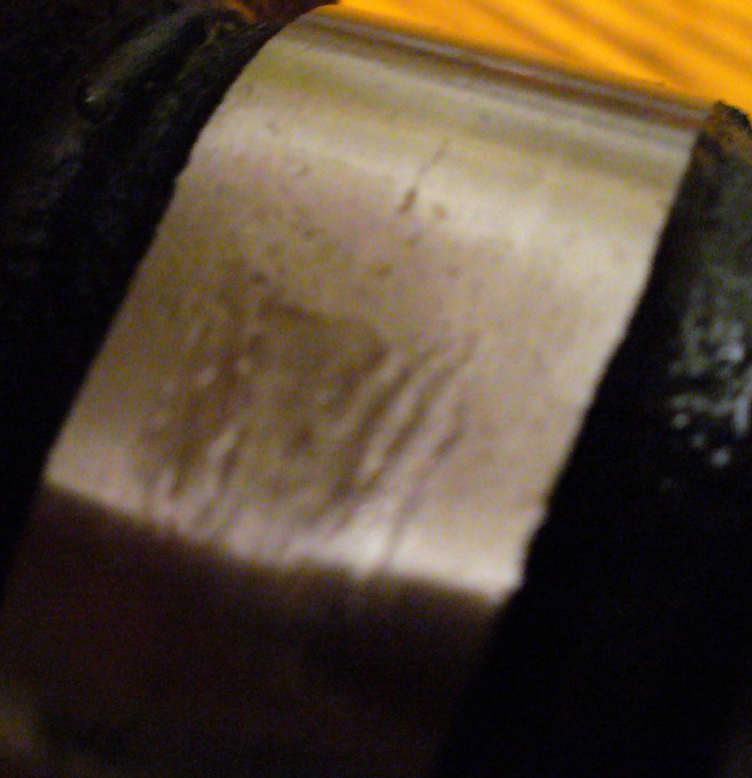

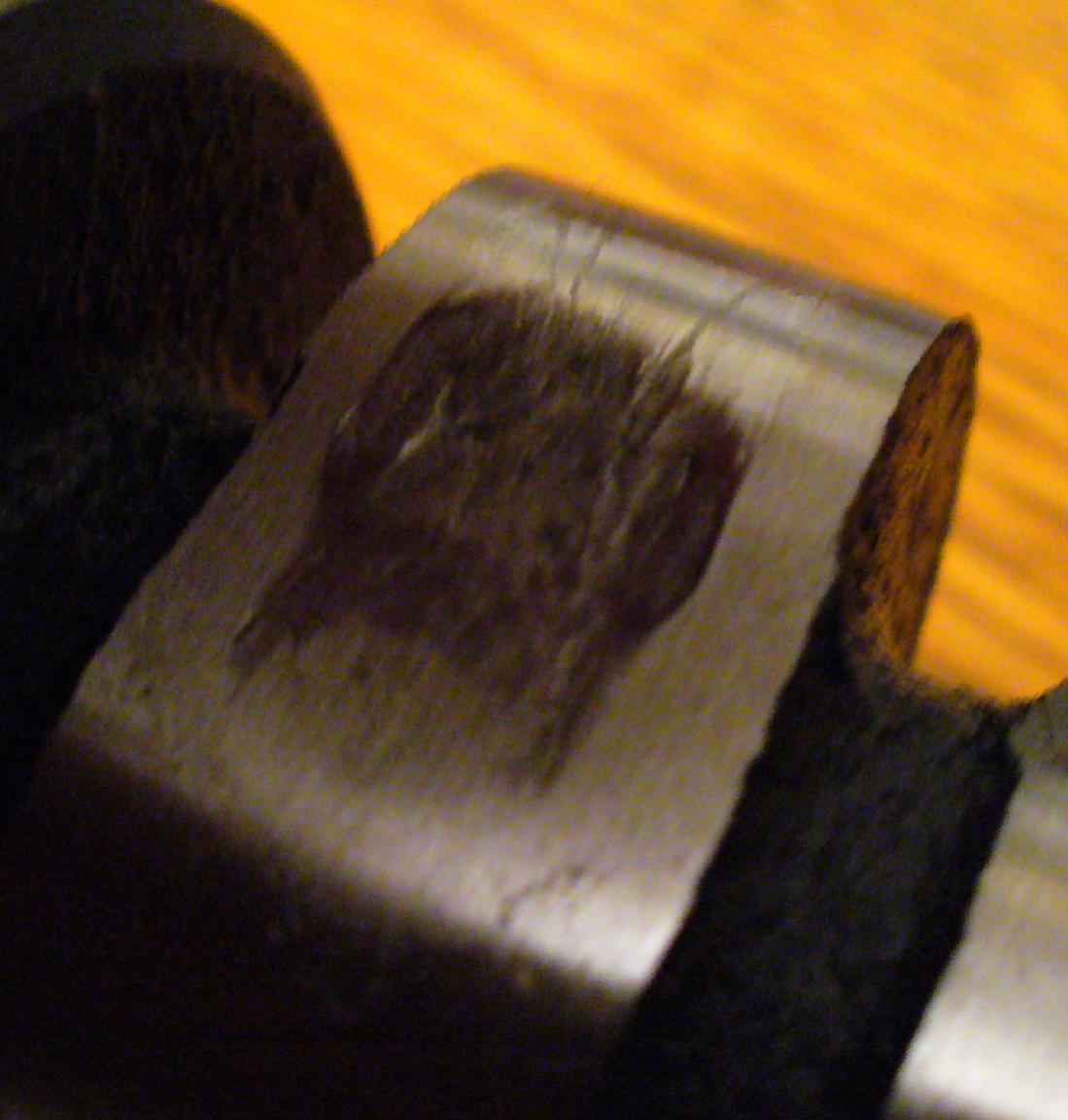

heres some pics of the ruined cam. one was done by a rod bolt im guessing due to the curved imprints on the #6 cylinder(1st pic). the other one is the #5 cylinder (2nd pic) and is the lobe next to the lifter that failed. this is the lobe with the lifter that the edges where rolled over kinda. the cam is ruined to this bad SPEED PRO lifter! AUGh! the rod bolt knicks would have been able to be smoothed out.
so DONT BUY SPEED PRO federal mogul lifters!

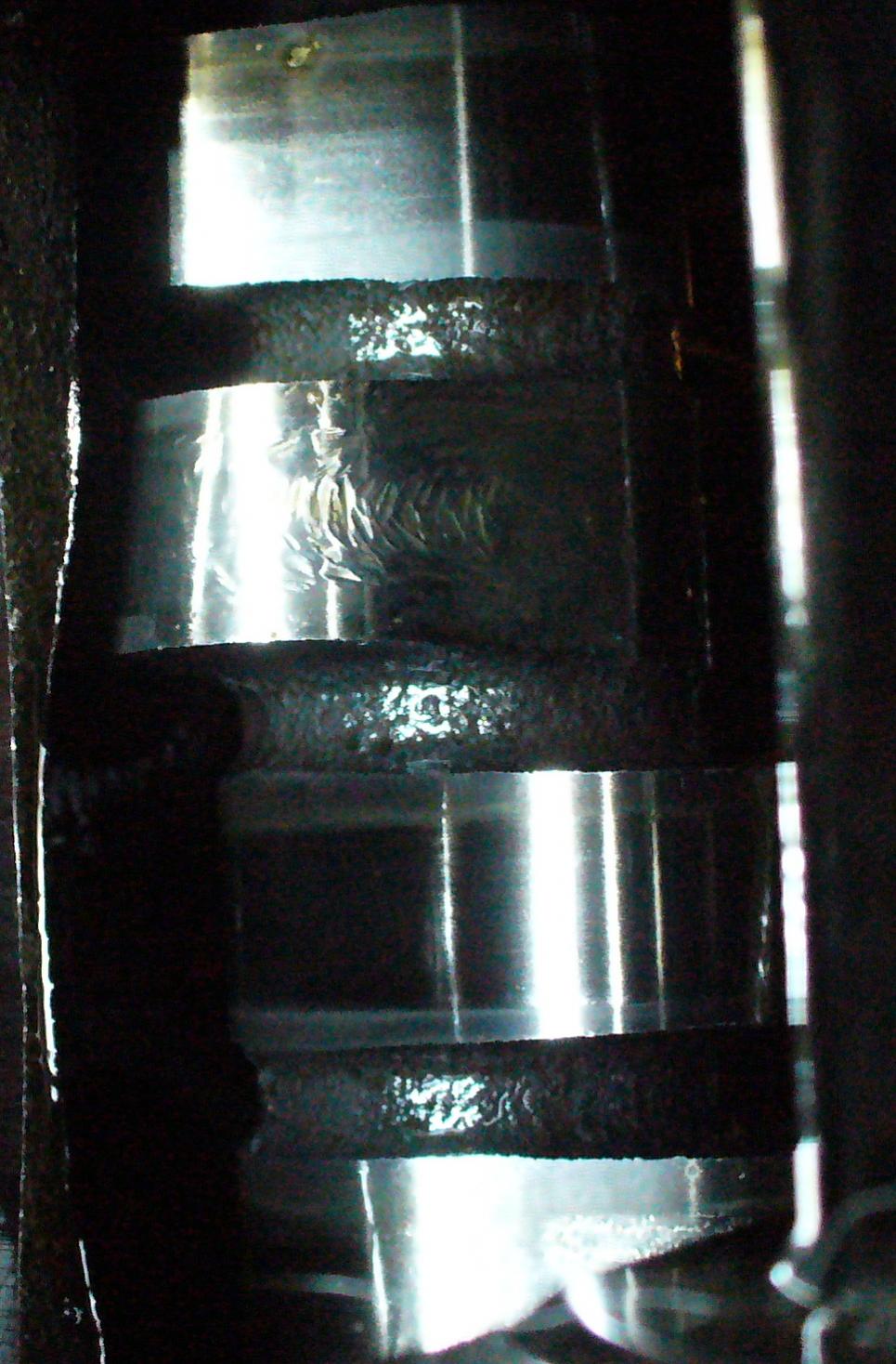

so heres an update....
took the engine apart and clearanced the #6 and #5 rods for more room, my guess about the rod bolt hitting the cam was correct on the #6 cylinder intake lobe. when pulling the engine apart i thought hard about the rod bolt and i dnt remember exactly but im pretty sure i screwed up(swapped the bolts) the bolts. The matched/clearanced rod bolt was on the wrong side of the rod. so thats where the grooves are from (see pic) basically the rod was clearanced but the rod bolt wasnt now. I now clearanced the rod/bolt even more now and i tested it. i now have .068 clearance as a minimum on both the #5 and #6 lobes. I then pulled apart the #1 and #2 cylinders and found that they were also clearanced for .068 minimum...
my guestimate with why i figured i had only .050" clearance was bc I didnt have the cam and timing chain set up, i basically just spun the cam and slowly rotated the crank to get the clearances i had originally. this time i left the cam/timing chain assembled. so i have a minimum of .068" clearance... im hoping this is enough.
other pics are of the BAD lobe im assuming is from a bad lifter...(this was not done by the lifter that exploded... the bad lobe in this pic is on the #5 intake and the exploded lifter was on the #6 intake. this lobe that has a huge divit is on both sides of the lobe and continues over the peak of the lobe to the other side. this im assuming is from a lifter that turned in the bore. (see pics) this would also explain why my spider was bent up, and it cant be a rod bc the rod isnt near this rod (this lobe is below the crank counter weight).
im pretty sure this cam is ruined and that puts me 265$ in the whole, not to mention 120$ for new lifters. what do you guys think? does this look like a failed lifter that grooved the cam lobe?
these 2 pics are of the failed lifter #5 intake lobe.

these are of the rod contact on the #6 intake lobe. u can see the round half circle indents.

well i guess this got confusing... sry ty_rich, ill sum it up for u.
1.) kept breaking rocker studs and having loose rockers/loud tapping under valve covers, well not loud but too loud for a full roller setup.
2.) a lifter puked its insides all over the inside of my lifter valley.
3.) cam lobe cam in contact a smidge with the #6 rod.
4.) cam lobe on the #5 was severly dented/dimped by a bad (brand new!) lifter.
now the answers in order to the questions above.
1.)rocker studs were breaking due to bad lifters... i would set lash correctly and engine would run great but after a while the lifters wouldnt pump up.... causing too much play in the pushrods, this would cause the pushrods to SMASH into the cup of the rocker and act like a hammer pulling/smacking on the rocker stud. Also excessive play in the pushrod would allow the pushrod to walk to the edge of the lifter and BAM suddenly act like a solid lifter and cause the pushrod to snap. This also caused the exploded lifter.
2.) exploded lifter was caused by too much pushrod play due to poor lifter quality causing the pushrod to catch the wire ring that holds the insides of the lifter inside the lifter, marks were evident on the wire snap ring, this would cause the lifter to explode and shoot its insides in the lifter valley.
3.) cam lobe #6 has bolt groove marks this was easy to see and would have to be a rod bolt. tear down of the engine revealed that i mixed the clearanced and non clearance bolts on the #6 rod, so basically the nonclearanced rod bolt was hitting the lobe, where as the clearanced rob bolt was on the other side. I fixed this and grounded the rods alittle more giving me a min clearance of .068" on cylinders 1,2,5,6... which are the problematic rods on a 383 stroker.
4.) the #5 lobe on the cam has a dent in it and is scored around the top of the lobe from one side to the other... this means lifter issue. since the lobe is not near any of the rods but is on the counter weight side. basically the ;lifters arent pumping up and caused the pushrod to catch the edge of the lifter and suddenly act like like a solid lifter and could dent the softer metal of the cam lobe... this would also cause the lifter to push up to high in the lifter bore and cause the spider tab thats holding the wish bone to bend upwards (which it was).
so in all... all 16 of the brand new speed pro/federal mogul lifters are all CR@P! and can not be used, made in the usa but assembled in india is what they should put on the box! now the lifters have destroyed my 265$ cam, and i have to replace 130$ worth of lifters not to mention it destroyed 2 sets of rocker studs and i need about 80$ worth of gaskets. im pissed
