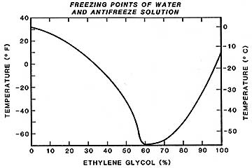

60% antifreeze 40% water is about the minimum freezing point you can get
http://www.gi.alaska.edu/ScienceForum/ASF6/680.html
I agree. He can always stop by an auto parts store and read the back of a Prestone jug to see just what the max protection can be.
IIRC going beyond the recommended mixture actually RAISES the freezing point, not lower it. So, don't get creative, just follow the mixture recommendations.

50% is recommended because its a lot cheaper than 60-40 and most people dont need to go to as low temps as you can get with 60-40 mix.
around here, the coldest it gets is mid teens, so i could technically get by with 20% antifreeze and be completely fine
