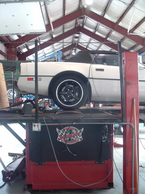

I ran the stock TPI on a mild 383/700R4 in a 1990 Corvette. It may not have been the fastest car (258rwhp), but boy was it fun on the street. The huge low-to-mid torque hit was giggle-inducing, tire-melting fun. I will probably do it again when the stock engine starts to go in my Formula...
