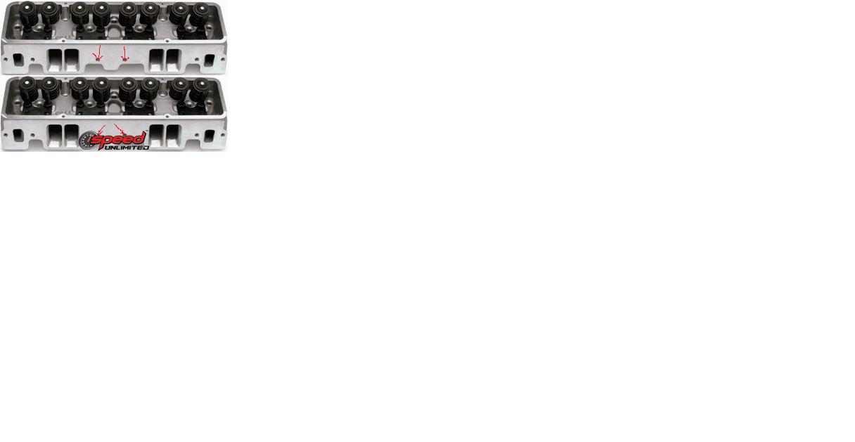

im not sure if it would be roller. see what the engine rpo code is. the bolt holes in your stock heads are at a different angle. you would need to modify the intake

Re: thoughts welcome
so to mod the intake would that just involve drilling new holes? or could i just reangle the current holes?
the easiest thing to do would be to get a 85 corvette (they didn't make corvettes for one year, i dont think it was 85) lower intake. another problem i just remembered that i had was the intake ports in the head may be taller than your intake rendering everything useless. thats the problem i ran into and thats why my 84 has a carburetor on it instead of the tuneport. if you still want tune port it will be easier to go with L98 heads.
ok they didn't make corvettes for 1983 model/year. just find out the intake port dimensions. they need to be about 2" tall. you can elongate those holes with a drimmel type tool. just make sure you have enough room for the head of the bolt.
