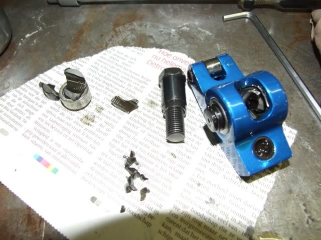

Looks like Prime 1 Rockers.....those are great rockers...
if you want to screw up your engine that is.
They are not scorpions!
Here's more uglyness
http://forums.corral.net/forums/show....php?t=1037191

those are just like the proform rockers.. the hardened material in those style rockers are HORRIFIC!! the set I had the bearings wore through the fulcrum the poly locks were chipping in less then a 1000 miles my engine at that time was flawless... all that nice material goes where OHHH yes inside your engine.. I would stay away form that style rocker!!! step up and get HD stainless or chrome moly!!! rockers at least proform was great.. I sent them in. they knew they were bad they changed there design they sent me a new pair I SOLD THEM
looking at the pic... of that rocker someone had a clearance problem.. or they were not adjusted correct

That pic is from a guy here that knows what he's doing, they were sold to him by a cam grinder as being scorpion rockers. There were no clearance issues, they exploded from the high spring pressures

TT While I feel your pain with your busted rockers, those are neither Summit brand or Scorpion rocker arms and are not evidence that either the Summit branded or Scorpion rocker are sub standard.
Reguardless..... it takes a lot of force/shock abuse to create the failure you experienced. Like valve float/crash.
I have not used the Summit branded narrow body rockers specifically but the conventional wide/full body aluminum roller rockers are top notch and if they are not actually made by Scorpion, are a dame good copy. Mine (plain/natural aluminum finish) look exactly like the Scorpions without the Iodizing colour finish. If these Summit rockers were a cheap piece of crap they would have gone back to Summit a long time ago.
