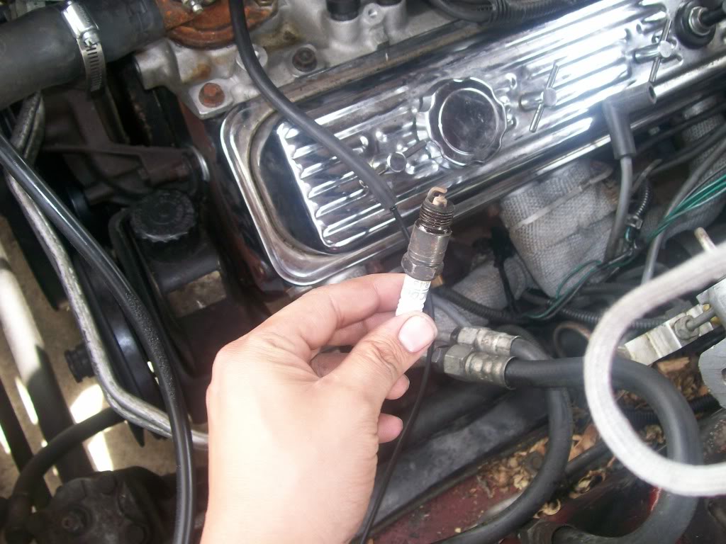

Re: car troubles
heres the spark plugs.... Name:  103_1496.jpg
Size:  131.1 KB Name:  103_1497.jpg

Need clear image of plug only from tip to threads.
