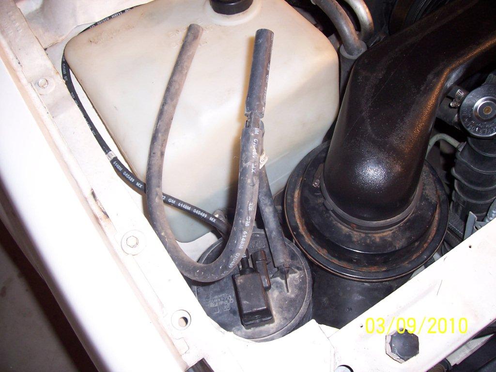

I'm getting a Haynes tomorrow because i hate asking dumb questions. What is this and why is it unplugged and theres two hoses that are going nowhere.
Also I'm leaking coolant from the thermostat housing bad casket time to change. Should i get one from the dealer or is there one just as good for cheaper.

If I'm not mistaken, that port is supposed to be left open to atmosphere. Why there would be hoses on it I don't know. Should be just an open port with nothing on it.
Thermostat gasket you can get anywhere- it's still just a standard SBC thermostat gasket- nothing special needed.
that's your air canister, part of the sniffer test pre-requisite... I'll post a picture of mine in a few minutes...

There is a plug that is not plugged in on top the other end is wrapped in tape why would that be unplugged. I want to plug it in but i don't now what it is for.

is your car running like crap? You will need the emissions diagram.. I am not sure if the Haynes manual has that... Previous owner may have plugged the vacuum lines...

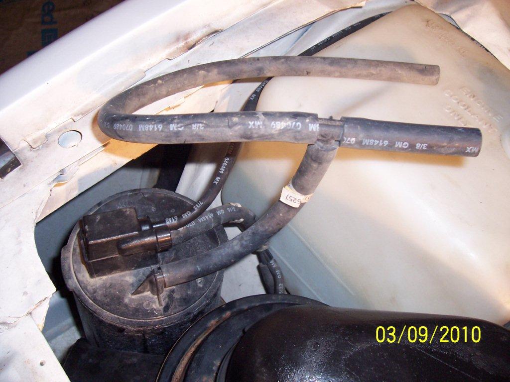

I see so i can remove the hose if i want but yours is different theres no box at the top that you plug a plug into i will post a better pic

Nice job on the pic mine is the second one i will be saving this pic thanks. So the purge solenoid is disconnected i take it this isn't needed.
