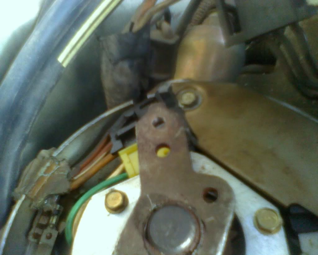

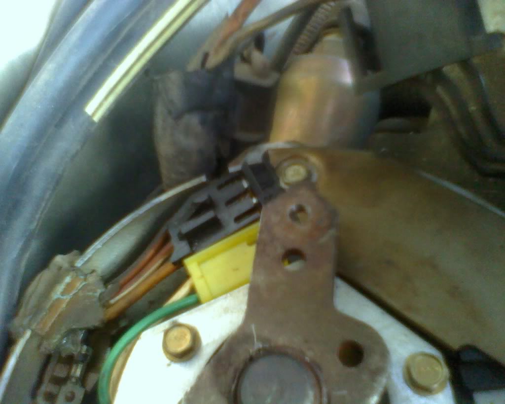

well i replaced the pickup coil not too long ago and the dist cap. while i had the distributor out, i checked it all out and it was good other than the part i replaced.
my timing was checked and good as well.
its gotta be something fuel related. alot of my friends say either the filter, injectors or pump.
im betting its the pump because now it sputters to death with any amount of throttle and barely stays running at idle.
im going to replace the pump and filter in about two weeks when im off and see if that does the trick. if not, i guess the injectors would be next.
but this sounds like what happens when a fuel pump gives out right? does anybody know? its an electric in tank pump.

I checked the cap for movement. It was the slightest bit delayed when i turned the crank. but barely. i dont exactly know how much of a delay to look for. i did notice tho that something under the cap was very loose, i think. here are the pics...
this piece here is pointing about two thirds of an inch to the left of that screw. it moves quite a bit to the right when i wiggle it.
when i move it to the right, it is now just slightly to the right of that screw!
is this normal??? the distributor shaft that it is attached to does not move when i wiggle this part. should this bracket be solidly attached to the shaft? it should right? is this what could possibly be throwing off my timing???

If I understand what your saying, than yes, that is normal. That is your centrifugal advance, and it should wiggle if you try to move it.
