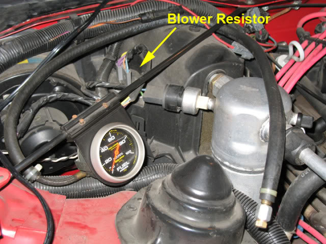

Check the blower resistor. Remove the plug and the fasteners. Remove it from the duct work and inspect the underside. Most likely you'll find some burned out wire coils.

The fan's high speed doesn't go through any of the resistors. The resistors are only for the slower speeds. All they do is reduce the voltage to the fan motor.
You could try replacing the resistor block but I doubt that will fix the problem. My guess would be the fan switch itself. Some electrical diagnostics will need to be done to isolate the problem.
