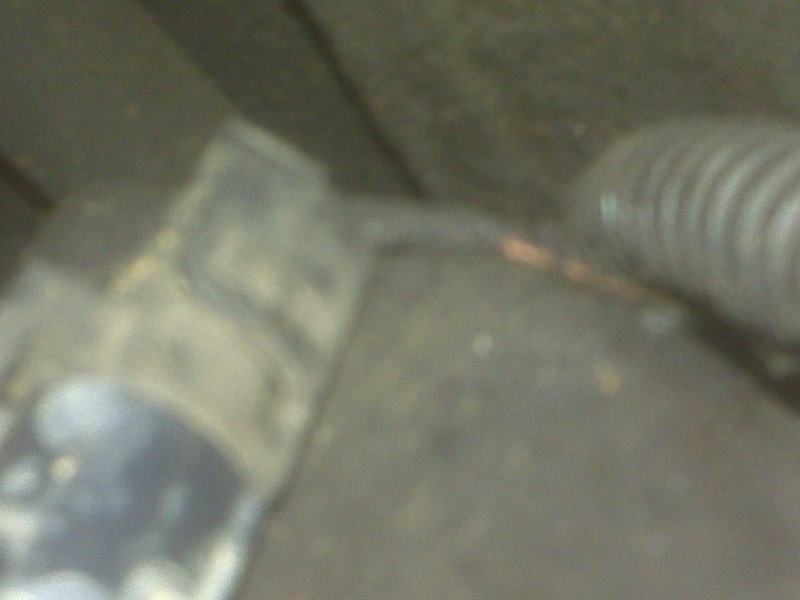

OK gotta update.....ITS FIXXED!!! after $600 inparts i finally fixxed it with a damn piece of .50 cent tape. I got so pissed that i went back and reexamined everything i had done, checking that all the sensors were plugged in good and really looking at the wire to each sensor. well the O2 sensor wiring runs in a loom with the temp sensor. it exits the loom and runs unprotected for several inches and its routed to the front of the motor by the motor mount. i moved the wire back and looked real close and sure enough the damn wire was bare and had been shorting out against the frame. i removed the wire and rerouted it and repaired it. plugged it all back in and damn! it runs great with all the new parts in it. lol so if you have a car running really really rich i can tell you first hand a shorted O2 sensor will do that. heres a pic of the wire...kinda blurry but you can see the copper exposed. thanks for all the help. i hope this helps someone havin the same problems as me.
