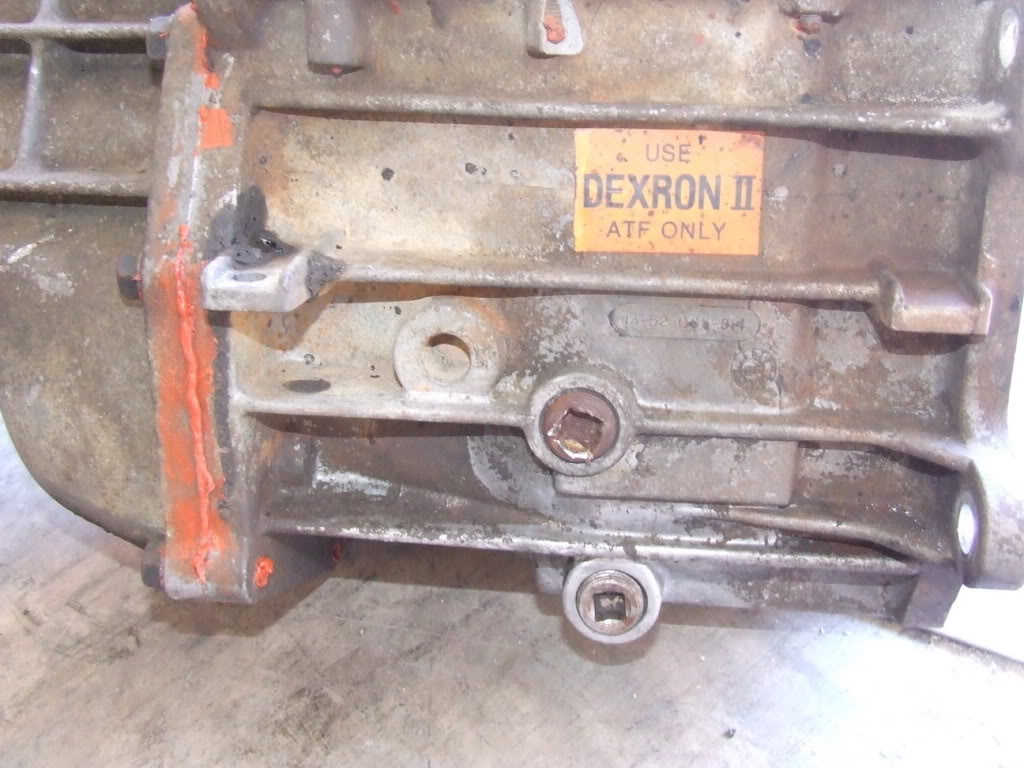

Here's what I'm working on:
Its the upper fill plug on my T5. I have tried to use a chisel/punch to move it, but its soft and both just dug in instead of turning it.
Any ideas on removing it effectively?

Maybe an easy out bit, or you could try dremeling a slot in the head and use that to get it out. Those are the ways I know, there are probably better lol.

I'd drill a relief hole then use an EZ-Out on it.

Just grab a 1/2 in bolt and grind the threaded end square to fit the damaged plug, and pound it in and out she comes..........has worked for me many of times.

also try getting it hot too, a little heat goes a long way when tring to un stick a plug.

Weld a bolt into the hole then put a wrench on the head of the bolt and unscrew it.
but put some wd40 and use an impact instead of wrench.

An impact may break the welds. You don't get a lot of area to run a bead and only need enough force to break the torque of the plug. If you have to, use a socket and a breaker bar if a wrench can't do it.

you got to use heat. get it nice and hot and wile heating it up spray wd-40 on it to let the wd seep in to it.
with heat it will come right out. use mapp gas.

if its hot enough i dnt think a 3/8 impact starting with lil trappings will break it but yea breaker bar should do the trick

use the end of the ratchet with a 1/2'' extension..thats how i got mine out...
