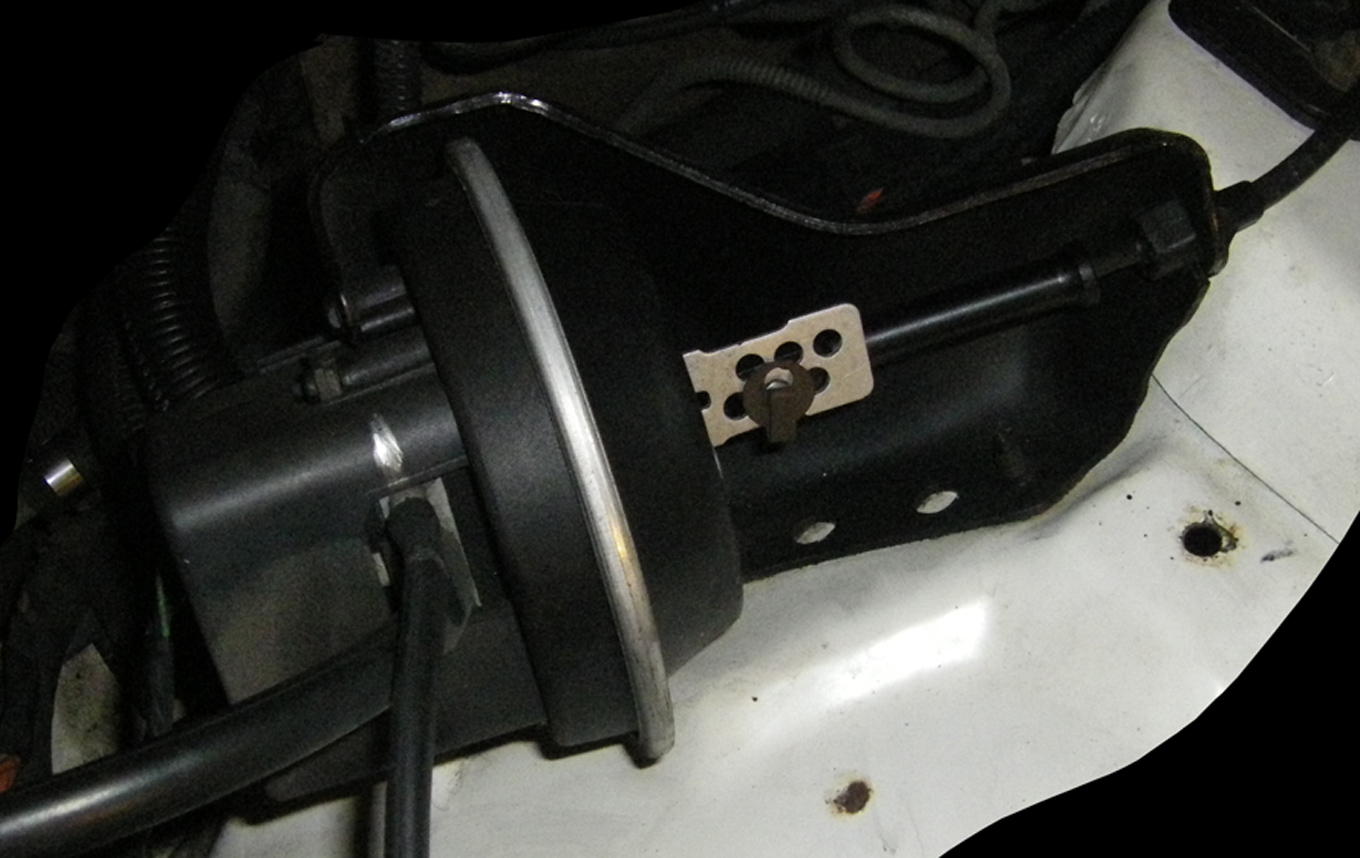

What the heck is this?
Removing the small hose released some pressure, and i notice it as some sort of moving diaphragm that connects in some form to the throttle.
What is it, what does it do, and where the heck to those two hoses coming out of it lead?

Re: What the heck is this?
Cruise control servo.
Man, that is your cruise control diaphragm. It runs of the engine vaccum.
And it most certainly connects to your throttle linkage.
well that was quick, informative and exactly what i was looking for.
another question, if i remove it by doing nothing but disconnecting it, as if i just cut the wires and tubes right off, what happens ?
also if i wanted to remove it to clean up my engine bay, what modification to the throttle / computer / etc will need to be performed.
Sorry for the noob questions but i am learning fast
No, don't cut the wires, if you want to remove it do it the right way, just unplug the wires, disconnect the cable that goes to the TB, and plug the vaccum port at the intake manifold and unbolt the diaphragm from the chassis. You can sell it on ebay, or save it for when you get older and need the cruise control on long trips like me. LOL
You should keep it. It doesn't add any real weight to the car and it doesn't affect acceleration at all. Have you even tried using your cruise control?
