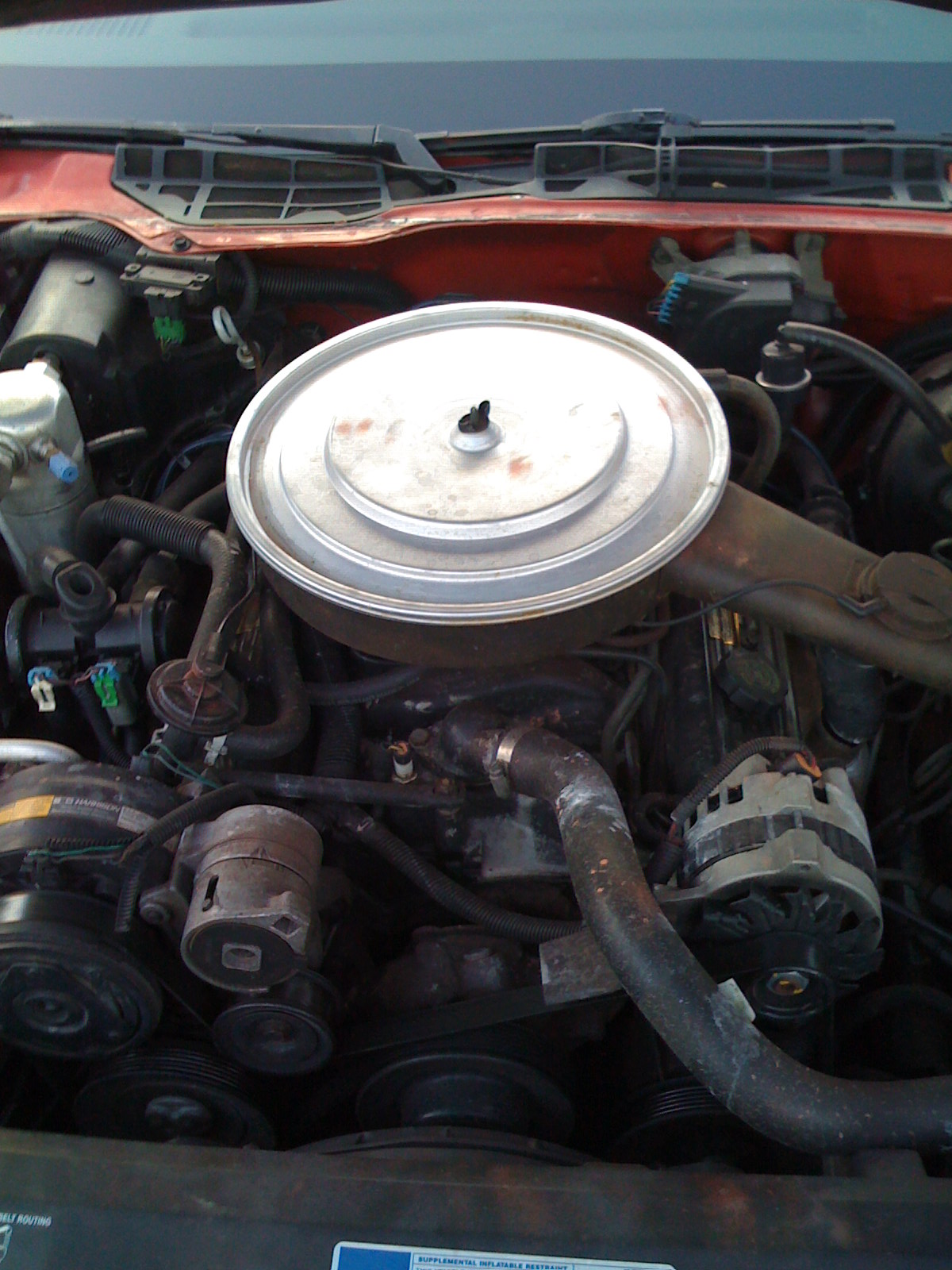

Old Nov 28, 2010 | 03:45 PM
rich5's Avatar
Joined: Oct 2009
Posts: 134
From: Berwyn, PA
Car: 91 camaro RS
Re: How can i a tell 305 from 350....
titles at dad house, couldnt tell you
Old Nov 28, 2010 | 03:51 PM
383 Power's Avatar
Joined: Jul 2010
Posts: 500
From: Shreveport, LA
Car: 1982 SC/1984 Z28
Engine: 305 4BBL/305 4BBL H.O.
Transmission: 700R4/700R4
Axle/Gears: 4th Gen 3.23 Posi/3.73 10 Bolt
the only way to know for absolute certain is to look at the serial numbers. It looks like it's PROBABLY a 350. I think i saw the dipstick on the driver's side. Can you remove one of the Valve covers and get a shot of the Cylinder Head's Serial Number?

Old Nov 28, 2010 | 08:27 PM
five7kid's Avatar
iTrader: (14)
Joined: Mar 2000
Posts: 43,187
Likes: 46
From: Littleton, CO USA
Car: 82 Berlinetta/57 Bel Air
Transmission: 4L80E/4L80E
Axle/Gears: 12B-3.73/9"-3.89
Originally Posted by 383 Power
If your Dipstick is on the Passenger side, there's a good chance it's a 305. If it's on the Driver's side, it's PROBABLY a 350.
Originally Posted by Apeiron
A dipstick on the drivers side only tells you that it was swapped. There are lots of 305s with dipsticks on the driver side, and lots more 350s with the dipstick on the passenger side.
Correct. Dipstick on driver side, '79-older. Dipstick on passenger side, '80-newer. 305 & 350 changed at the same time.
Get the casting # off of the block. You can't make a 350 out of a 305 casting.
