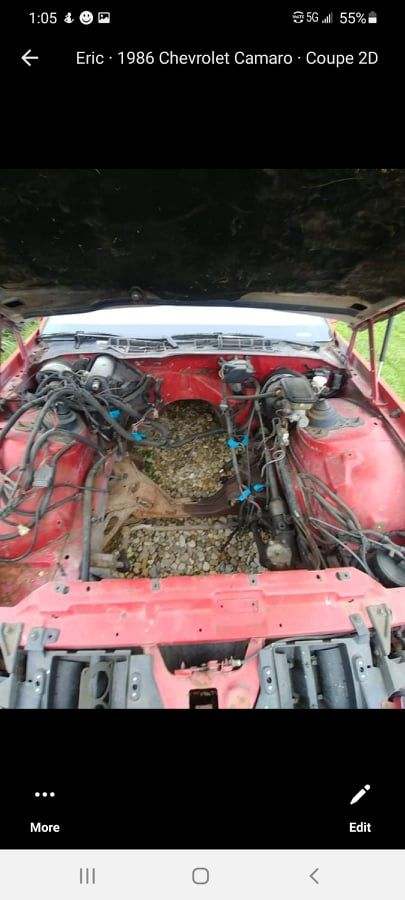

That I'm not sure of.
At some point, they changed the nature of C100, and put a bunch of the ECM wiring over there instead. Don't know the year.
You can look and see: if there's a big fat harness coming out of your pass side fender right by the blower motor, then this instruction would apply.
