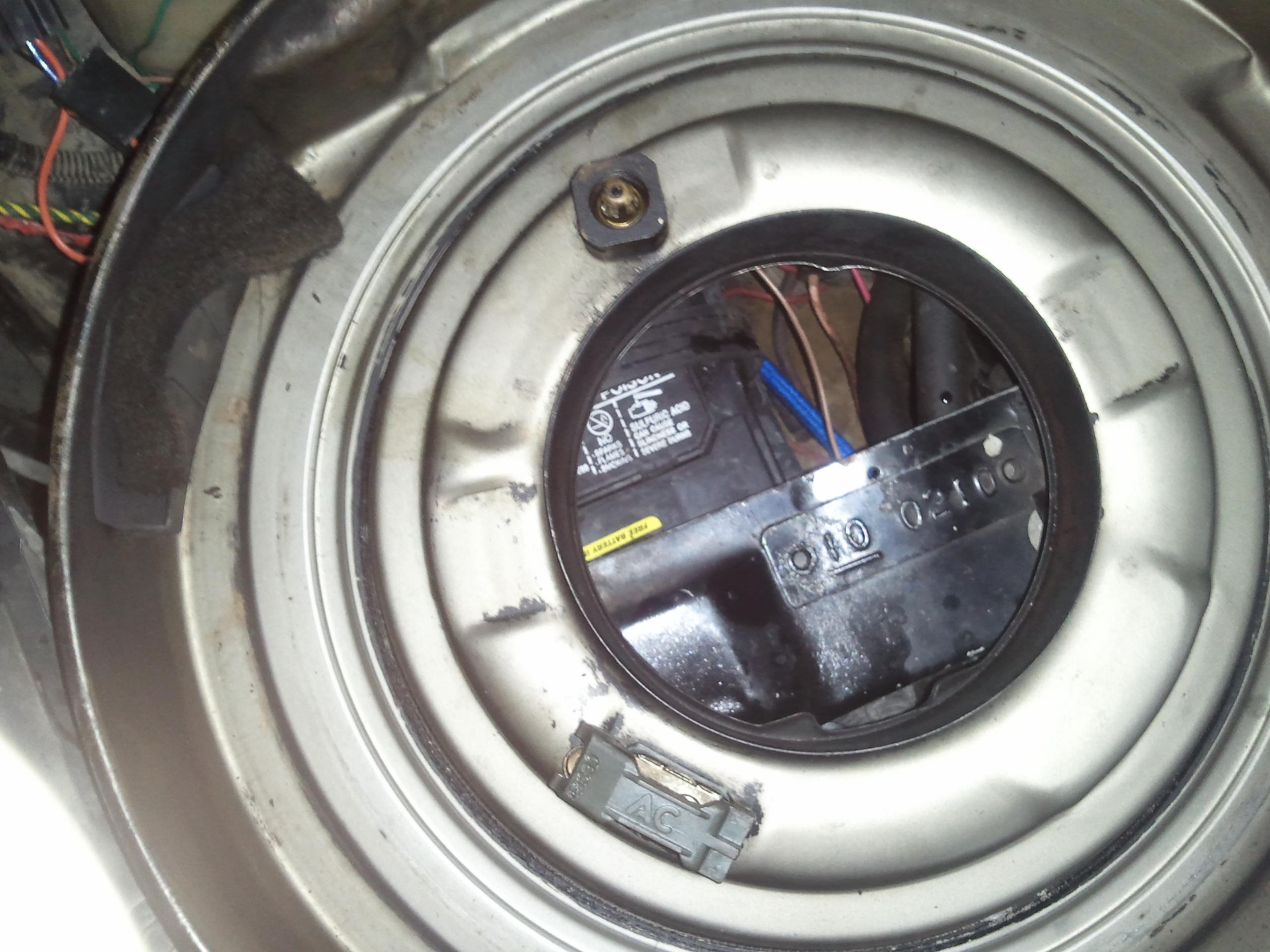

I looked and could find a post on where it is... found out about it (first thought I had a MAF) but not where it is... or where the plug for it comes from cause I cant find it either....
I'm trying to sort out some more crap the PO got it into... I'm idleing high and if I'm running normal speed and coast rpms will drop and rev dropn and rev untill it drops about 10-15 mph... and when I stop it rpms will just all of a sudden drop and it out unless you catch it and hit the gas just a bit and the whole car surges (I stop a bit behind the guy in front of me)...

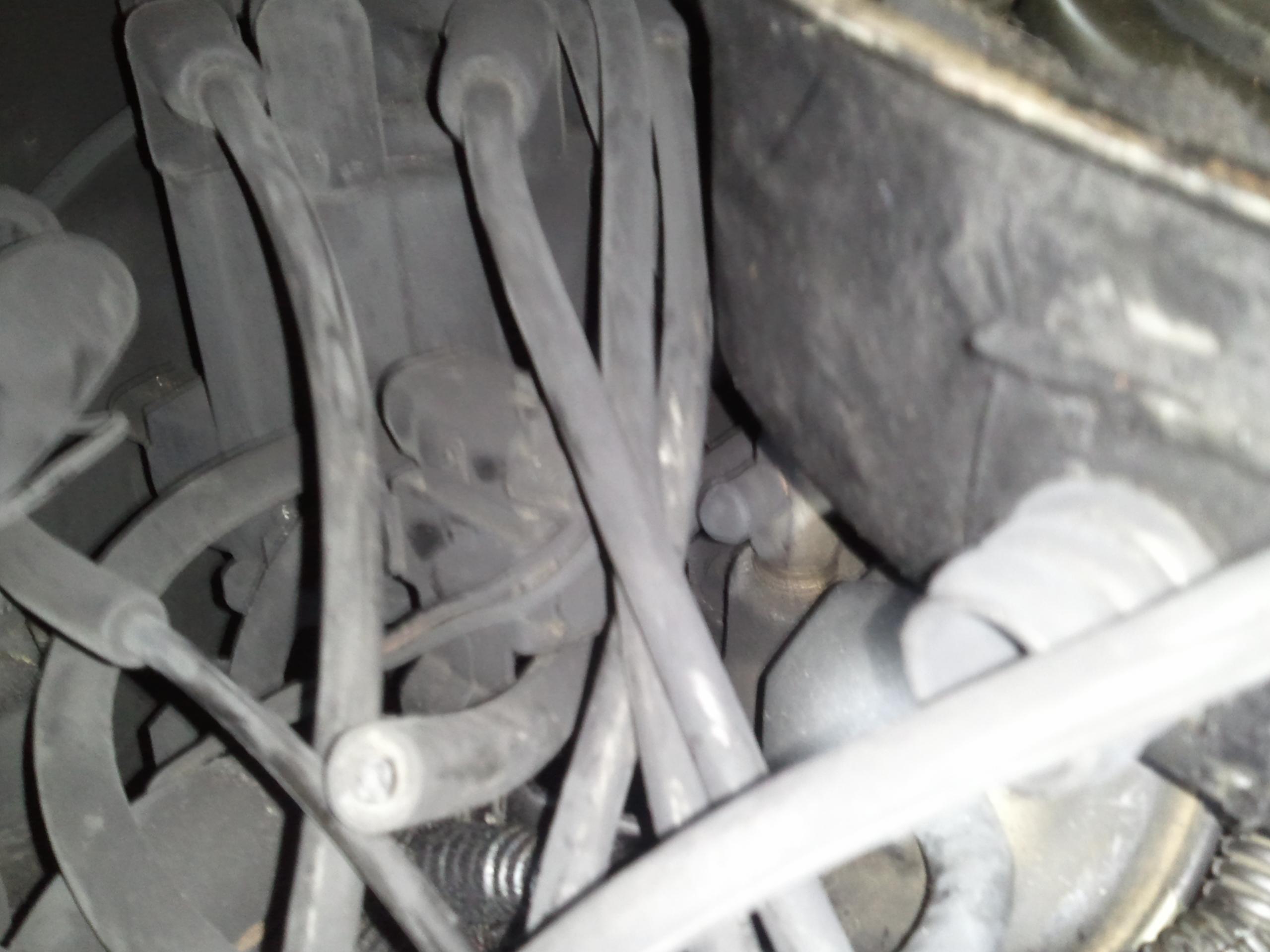

But in trying to locate it I've run in to a couple more questions... In my air cleaner there are two things, one is a plastic "clamshel" around metal flaps that I believe is a temp sensor I found on the vacuum diagram cause it gets a vacuum line... the one at the top I dont know what it is... looks like a sensor and gets a power plug... and then (last pic) behind the throttle body theres what looks like a sensor coming out of the block that is hex shaped with what looks like a vac line caped off...

You should have a vacuum line coming out of the back of the throttle body running to the MAP sensor. The sensor is actually on a bracket mounted to the firewall, and if I remember correctly it has a 3 pin connector plugged into the bottom of it.
There is a temp sensor in the air cleaner.
On my car, the vacuum line that you have capped off runs to the EGR solenoid.

The back vacuum line out of the TB on mine goes to the MAP sensor. I think the one that you have capped off on the intake manifold goes to a T on mine, 1 of them goes to the EGR solenoid and the other to the canister in the front of the drivers side fender. Then 2 lines come out of the EGR solenoid, 1 to the EGR valve and the other to the front passenger side of the throttle body.

Factory, the MAP sensor was on a bracket that bolted to the cowl lip, and kinda hung there right in front of the firewall, not actually attached to the firewall. In your first pic, would be right at upper left corner of the 'lip' where the back of the hood meets the cowl.

Upper left corner, bulge in firewall flange, black box w/ green connector. Right next to heater box

High idle is generally from a rather large vacuum leak, a bad IAC, or someone setting the minimum idle air high to prevent the car from stalling
From your pictures it looks like you might have a few disconnected vacuum hoses which could be your sources of vacuum leak.

Hoses may be leaking, I'll have to check, but from the above diagram they're all hooked up right now... The one you see out is to the air cleaner... The one to the purge canister I have plugged because the solenoid is busted... And the ac/heater because I'm not sure where it goes because it was to the back of the tb... And I don't have a vacuum ball installed... Got one from a junker...
