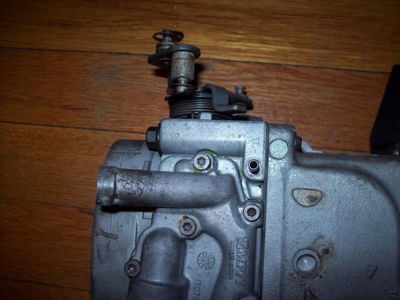

I have a 88 350 TPI that ive been taking apart for a rebuild and a vacuum line accidentally ripped when I took the intake off it caught onto somehwere, It goes to the bottom of the throttle on that really tiny part.

Is this easy to replace? I really hope its not something thats discontinued

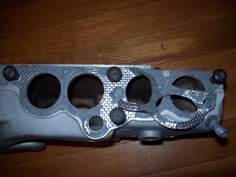

this thing was a real pain in the *** to get off...

That connection on the bottom of your throttle body goes to your egr solenoid. It would be the front hose on the solenoid to be exact. The other plastic hose coming out of the solenoid goes directly to the egr valve itself.

Your egr solenoid is between your coil and your distributer. It is a small black box with a rubber fitting that two plastic hoses connect to.
