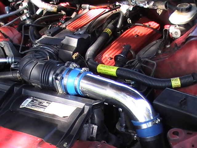

because it's pretty. Here, let's look at the true CAI system I have on my 4th gen. I've since added a chrome elbow (long tubes too) but a small filter right on the TB is so much prettier
Attached Thumbnails why do people have air filters on there throttle body-pic_0025.jpg
that looks good.
