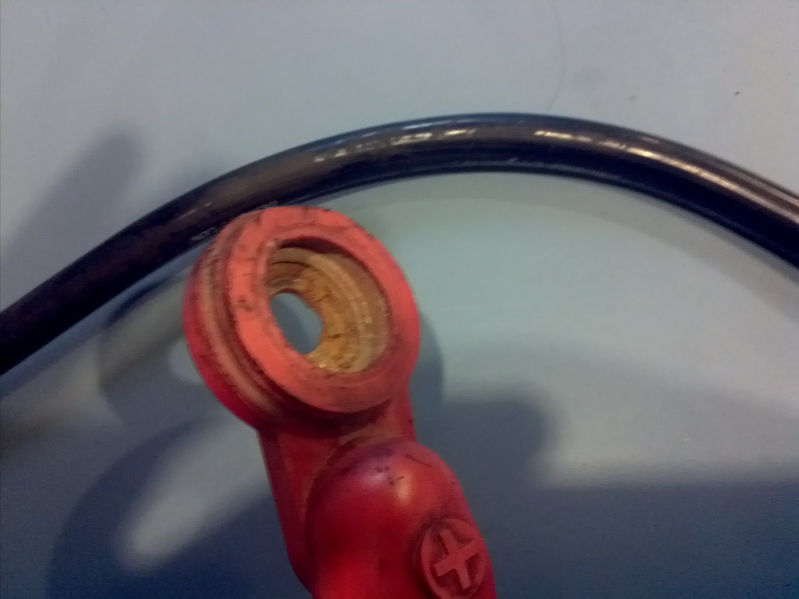

Re: Very frustrated, need help
Well... I am kinda embarassed to post pictures of these... but here they are.
I am either going to clean these up, and try them again, or replace them. I am pretty low on cash, but these are really gnarly once I took them apart and looked at them. I will post back later with what I decide to do and whether or not it helped.
The problem is another bad starter from Napa. There is actually green corrosion going up into the solenoid, after closer inspection of the starter. It will not spin on a bench. Single click, no crank.
I did purchase new cables (no fancy 0ga stuff this time, too broke for that) and I could not spin the starter in the car or in the bench, with all my very well assembled battery/starter/ground wiring...
Hey sieber still no dice huh? Looks like you found your problem, those connectors look pretty gnarly! And a rash of bad replacement starters - though with the cable problems, maybe your original starter is ok?
My cables did this to me earlier this year - looked perfectly fine on the outside but the battery ground was crumbling to icky spooge on the inside. It was intermittently able to supply the starter current, other times no crank at all but lights etc worked. So it was a bear to track down.
I stuck the terminal in a vice, have it a good tug and the cable shattered off the terminal just up from where it was crimped. The insulation had hidden the mess perfectly.
Only found this because I was bypassing all the big cables one by one in desperation.
The original may very well have been okay, seeing as how it would still spin. This one, on the other hand, does not spin at all. There is visible green corrosion on it going under the soldered post coming from the motor. Unfortunately, as I am replacing these on warranty, I don't have the prior one. I am just going to have to swap this one for another. Shouldn't be too bad, though, since it won't even spin on the bench.
The photos didn't do those cables justice. They were really, really aweful. It may not have caused and issues at this point, but it would have down the road.
