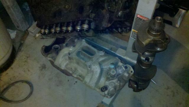

i just got done looking at engine told him id get back to him thurs looks good, he said he bought the crank new its pre machined aftermarket crank, its a gm goodwrench crate 350 has crank but not bored isnt a 383 a 350 block bored .30 over with machined 400 crank
what would this engine be considerd
he also said he couldnt get rpms up to 8k which he said thats what it was supposed to get too

those pics and these are engine it al so comes with edelbrock alluminum 4bbl intake

That's a 383.
Can't tell about damage to the crank from just picture, but new Scat cranks are pretty cheap. You can also get a good set of rods pretty cheap too.
Any damage to the block?

if the blocks not damaged $150 is a good price,if you look it over and don,t see any cracks in the block or any damage but the spun bearing, buy it and take all components to a local machine-shop for detailed inspection,and a writen bid on correct reassembly it might cost your a couple hundred dollars, for the inspection and $400-$900 to have rebuilt correctly but youll know what your dealing with, but remember a new 350 basic crate engines only about $1400

The crank looks pretty much smoked... the #1 rod and #1 main journals are ate up. YOu can see the copper in the #1 main in the one pic.
The block needs to have all the plugs removed, and then get a rifle brush run through all the oil passages to remove the metal chips before it is reassembled. I personally prefer to do that myself, at the quarter car wash, with a couple of cans of diesel fuel in a spray can (Gunk Engine Bright or the store brand equivalent) with an assortment of rifle, pistol, and shotgun sized bore brushes. If this is not done, it will surely eat the next crank in the first few seconds of running, too. Just dropping it in the tank isn't enough: the vat doesn't dissolve metal.
If it had the "goodwrench 350" heads on it, that's why it "wouldn't get up to 8000 RPM". They are among the worst of the worst possible smogger heads there are. That whole motor didn't start out life as a "performance" piece; instead, think of the cheeeeeeeepest possible replacement for a phone company van, to just get it back on the street earning revenue. While that's completely irrelevant to the block ("performance" doesn't originate there), it's CRITICAL to the heads. Myself, I do not even accept those heads as a gift, let alone pay for them; that is, "free" is too high a price to pay, because then I still have to dispose of them somehow. They actually have NEGATIVE value to me. Somebody basically ruined a bunch of what might otherwise have been perfectly good cast iron, by pouring it into that mold. I've paid people to come haul off piles of that garbage just to dejunkify my property. So don't expect much out of any engine built with them on it.

i will have a proffesional check it out before i have it rebuilt, thanks sofakingdom for the heads info other wise i would of probaly left them on
