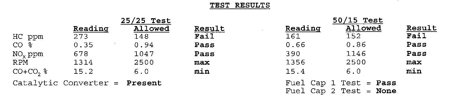

Hello. I need some advice. I have a stock 89 Camaro RS with a 305 TBI in it. Vin E. I took my car in for emissions testing today and failed. After only a year of having it, I replaced my cat 2 weeks ago because it was clogged to the point where my car had a major loss of power. So I replaced it with a magnaflow cat because it was direct fit and was cheap. I think around $140. So the cat shouldn't be the problem. The guy at the emissions place told me that my car was running rich. I am attaching the emissions test result. Any kind of advice would be extremely appreciated.
Attachment 232481
Have u checked for codes?

A lot of miles will likely mean worn rings with blowby which will give you high HC numbers. At that point I don't know if there is anything you can do but rebuild it or get another engine. How many is a lot?
I have seen posts if you were close to passing to change the oil, retard the timing, plugs, wires, run a can of injector cleaner through, and make sure it was run a full 30 minutes before testing to make sure its hot. Also make sure it is getting up to temp as in correct thermostat. Change air cleaner.
You can get real crazy and get a hotter coil - couldn't hurt. Need good plug wires and make sure they are not arcing

the aftermarket cats are not created equal, some do great at CO and NOx, but not so good at HC. others do great at CO and HC, but not at NOx.
without knowing what the pre-cat readings are, there is not way of knowing if it is running rich.
but from the numbers you posted, i would say it isn't. normally when its rich the CO will be higher.
a slight misfire will raise HC. burning oil fouls the spark plugs which can cause a misfire. it also kills O2 sensors and cats.
as was said by 308, dirty oil can raise HC and when you do the tuneup, pull out 1~2 degrees of ignition timing.
much more than that tends to cause HC and CO to go up, so clean and mark the timing marks and use a good timing light to check it before you loosen the distributor and again after you tighten it back down.
don't worry about what the timing specs say, go by the timing light to remove the 1 or 2 degrees.
sometimes you can pull up to 5~6 degrees and lower the HC even more, but without a 4 gas to verify the readings you wouldn't know, even with pulling just a little its a gamble at best without a 4 gas.

Guess what? It passed. By 1 point!
Sorry it took so long to get back but I wasn't able to get retested until today (work schedule) So what I did was replace the O2 sensor, changed the oil, and changed the air filter. It wasn't too bad. But it looks like I'm gonna have to search for a new car by next year cause I don't think my car will pass again. My luck seems to be running out with this car. I really want to thank everyone for all the suggestions on here.
