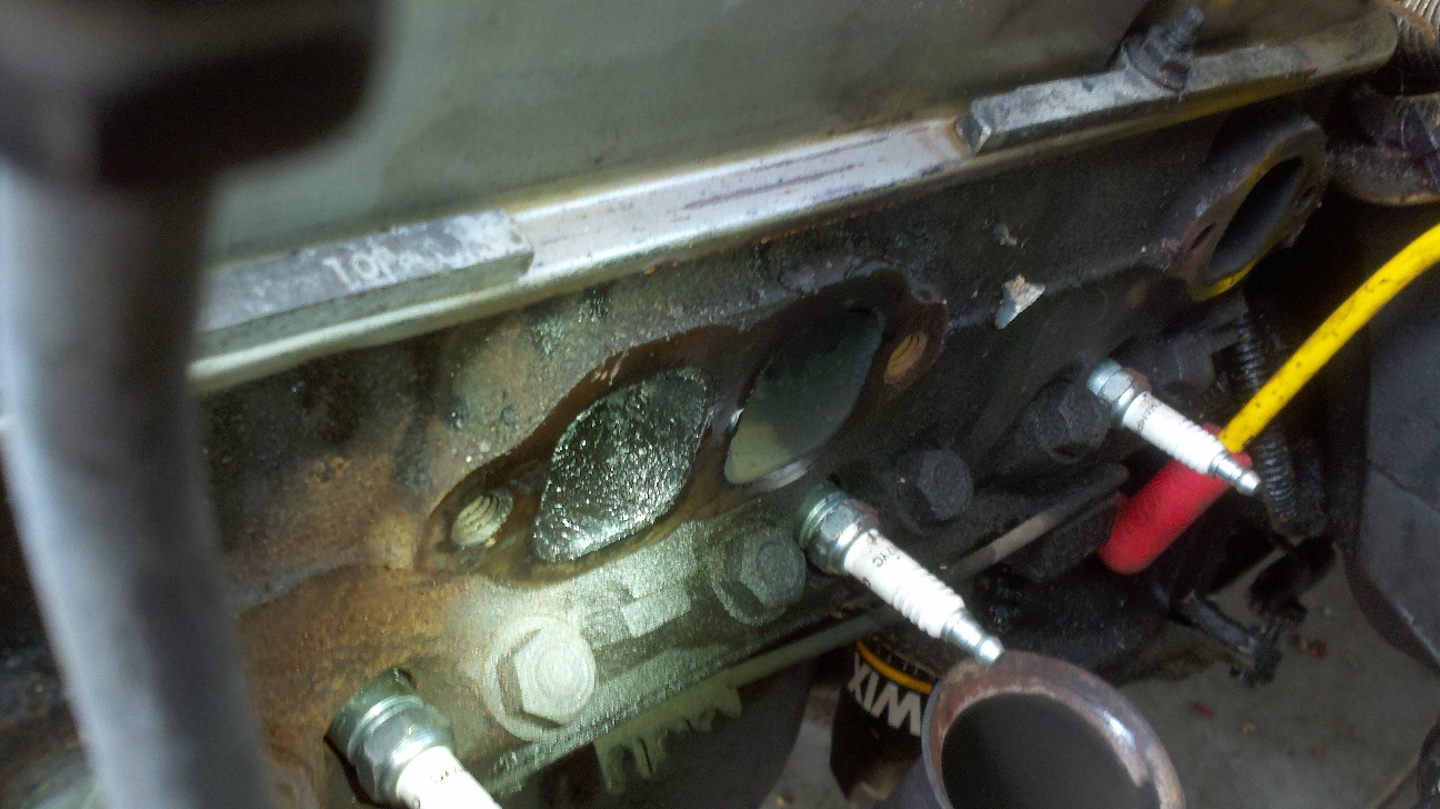

OK, I took off the exhaust manifold and found that in the second port from the front there is a good amount of oil residue. this is what was leaking out from the port and smoking. See attached photo..
Could this be caused just by a bad valve seal? I know I have needed them (for years). But the other ports look fine. Or maybe a valve guide just for that port?
Or do you think something on the bottom end? The spark plug did have lots of oil on the threads, but not on the plug itself. Combined with the noise, its worrisome. But as I stated above the compression test results appear normal..
Recommendations?
Thanks..
