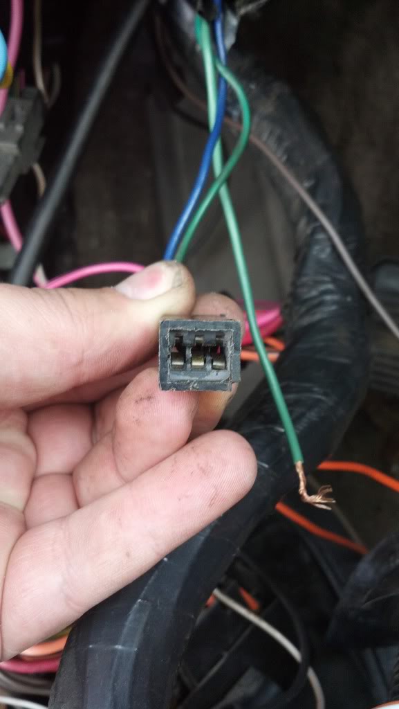

So i was rooting around under the dash and discovered some loose wires. Can anyone help me out by identifying and telling me what they are for. This car needs to start soon, or its gonna drive me crazy
