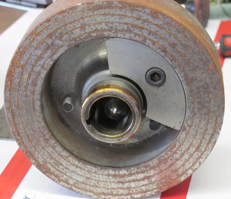

I gotta be honest, I'm starting to pull my hair out trying to figure out how my setup got balanced 9 years ago. Since the short block was built 9 years ago, I've taken it out to put in a different car and not running a T56 any longer but will run an automatic. So now the issue is figuring out what kinda flexplate to run. There was some confusion about it being a one piece rear stroker with an externally balanced crank, but the T56 needed an LT1 flywheel that I'm not sure if I found as "externally" balance or not? I remember talking to the guy on the phone about the balance issue (not local) and he told me if I could send them the flywheel and balancer that I was going to run....they would "make it work". I'm pretty sure that he mentioned something about possibly "neutrually" balancing it, but I'm not exactly sure what happened though. The whole internally/external balance thing can get a little confusing, so here's a couple pics of the flywheel and balancer. Can anyone tell what may have happened/how it was balanced?

Your flywheel was balanced by the removal of the metal in the making of the 14 holes of approx 1" diameter at the bottom of the photo . That was the heavy side , and they removed metal till it matched the light side ....
As to your Dampener , I don't recall seeing the extra bolted on weight that's on there being on any that I've seen lately , but then lately I've been tinkering with a six , so that may or may not be normal for an eight .....

The weight added on the balancer indicates a true "EXT " balance as only used on 400ci cranks.
