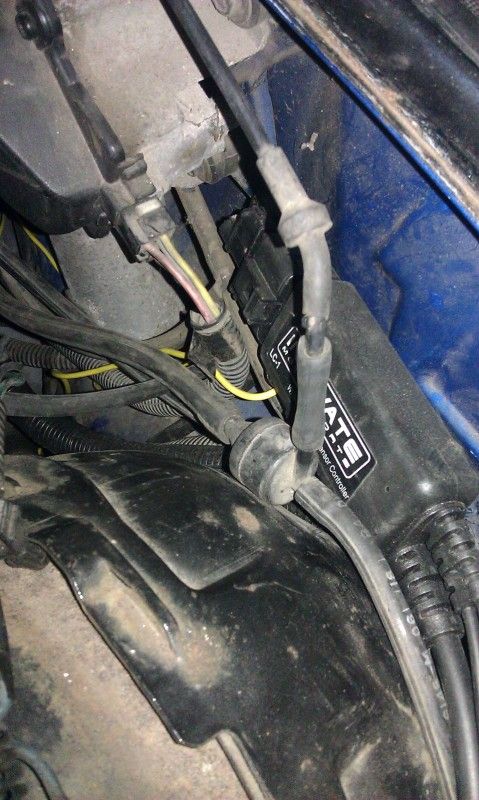

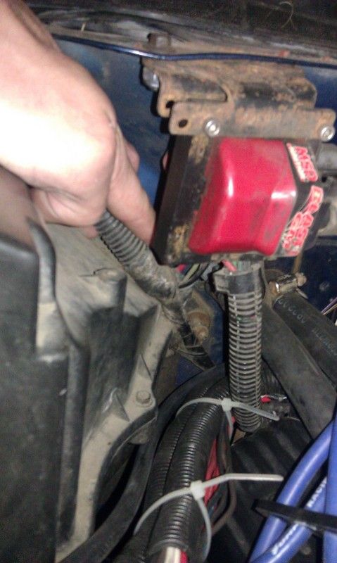

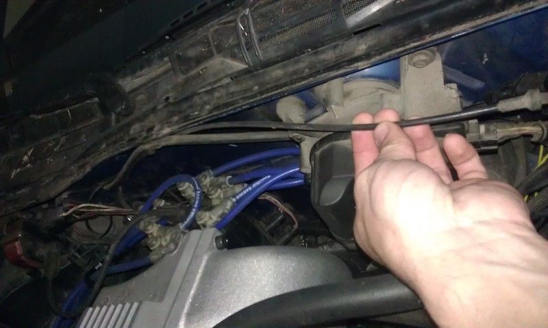

I took some pics for you and found the HVAC line actually goes over to the passenger side. But it gets its feed by the brake booster.

Right behind my coil it goes into the harness which ends up going through the firewall.

I don't know the exact original plumbing, but it should be something like:
Intake vaccum goes to a one-way valve (to keep vac in the canister), which then T's off to the vac canister and the hvac hard plastic line.
If the path back to the intake is left open, you will have a vac leak. If you leave the hard line unplugged, you will have no hvac operation but no other ill effects so long as whatever pipe that goes back to the intake is capped off.
Edit: LilSki posted just before I did - his first pic shows the one-way valve - vac fed from picture left, and T's off to the hvac and canister on the right. In his case though there is no canister (later model), instead a hose goes off to the 'orb of power' in the fender (same function as the canister).
