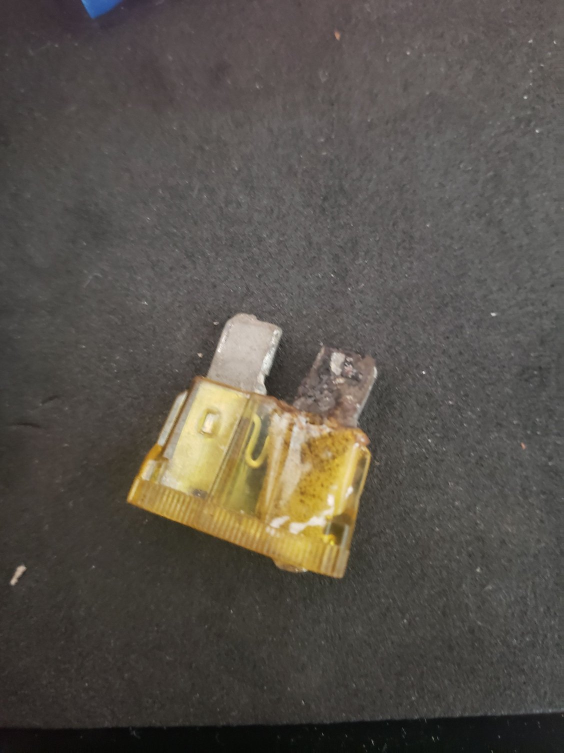

This right here. From 10 years in the past, YOU have solved my problem today. I was going through the same motions as the last guy when I came across this forum. Who knew there was a fuse all lonely and by himself up there by the battery. Sure enough, mine was toast. Literally melted. So thank you from the future! 2012 original post and in 2021 I found it. Happy motoring!

Did you solve the source of he problem? Fuel pump drawing to much amps?
It seems to be alright for now. Im going to keep an eye on things. For all I know the fuse got wet at the carwash. Its in a really stupid spot in my car. I will probably put it in a waterproof housing some day. As soon as I replaced the fuse, everything seemed honkie dorie.
