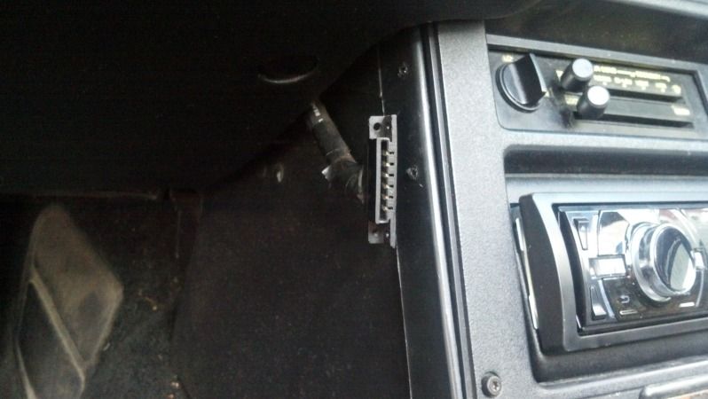

I lost the chip that goes in here and now can't get my car started
Ok so the guy told me it's some kind of anti theft device. Is this the VATS? I couldn't load a picture to find out what the VATS was. There is this small chip size of maybe a quarter or so that goes in here and without it I can't start the car. So I was pulling it out everytime I parked my car in the driveway. Now I lost it. So is there anyway I can by pass this? BTW it's a 92 z28 350tpi 5spd manual transmission.

That looks aftermarket to me...
Now ya gotta find the missing key or start tracing wires to figure out how to uninstall it. I don't envy you!

Yeah got underneath to take a look. It's aftermarket made by HELLA. I hate my life right now!
And aftermarket security devices usually use all black wiring so it can't be traced easily by car thieves

What a pain in the butt, I got it out and got the car started. My car goes for paint tomorrow too. Would've sucked if I couldn't get it started to bring it to the shop Thanks for the help guys!

That is old school I installed them when I was at the Chevy dealership when I first started it was called a pro lock.
