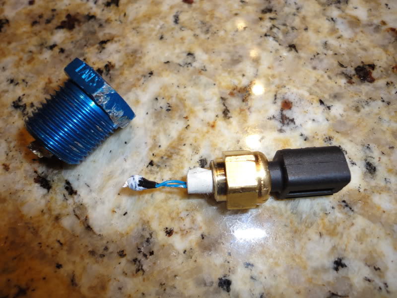

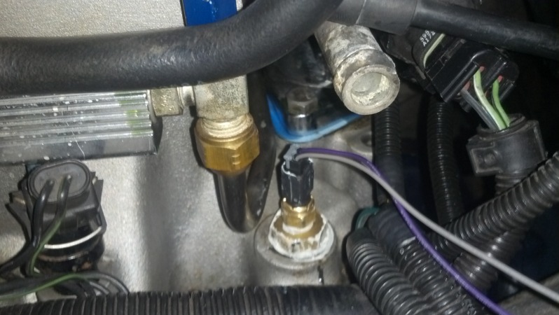

I read coolant temperature readings are much more accurate when read directly from the head vs the intake.
If this is not the case I need to know ASAP because I will gladly wire my fan switch into the 1 of 2 plugged 3/8 fittings on my HSR. I wont have to deal with all the extra fittings on the elbow thing I created to mount it out of the head and downwards away from my header.
And then the only issue with that is if the stock wiring will reach the intake....

Here is what I created so far...one for my fan switch on the driver side head, one for the autometer digital temperature gauge on the passenger side head.
Any advice is GREATLY appreciated and I have not even been able to drive the car at all this year for more than 10 minutes.
The difference in temp you will see is irrelevant for fan operation
In your case the argument goes out the window, because the adapters you are using put the temp probe
away from the coolant flow anyway so I bet they are reading low vs actual temp
No reason you can't have all 3 sensors ( CTS for the ECM, fan switch , temp gauge sender )
in that position if you don't have the heater line connected
At least all will be reading the same temp
Heard of a soldering iron or wire crimps to extend the stock wiring.......

I have the CTS in the manifold to the right of the thermostat. I have two extra plugged 3/8 fittings that I can run the sending units into. I wish there was a little 1/8"er for the autometer gauge.
My heads get hotter than my intake (or at least they heat up quicker) which is why I thought the sensors needed to go into the heads.

Yes I know reducers exist, at the moment I am going to use the provided autometer 3/8 to 1/8 brass reducer because....
My earls reducer snapped my sending unit when it was tightened in my vise.
I might be coming off as un-informed but I've been working on this car since 2001..

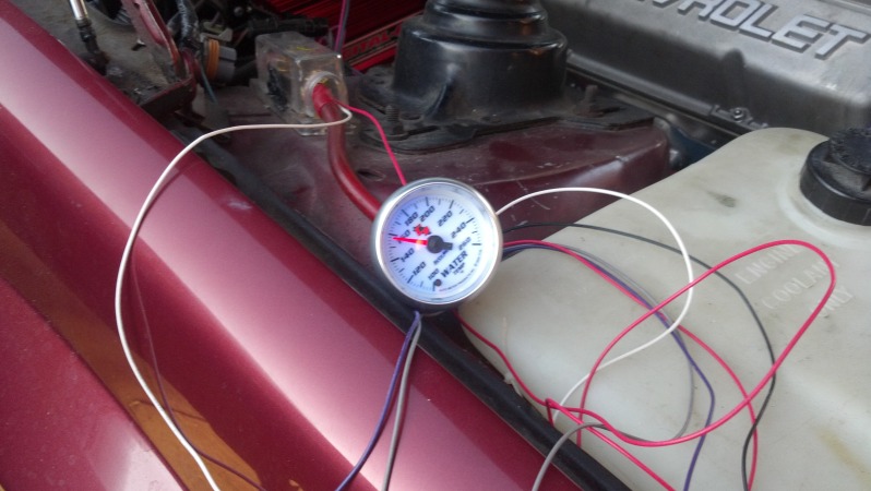

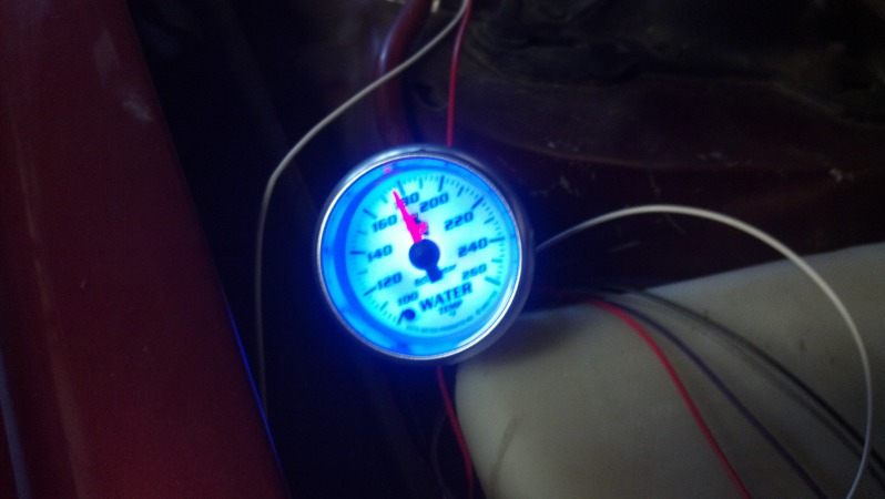

Decided to take vetteoz and maddens advice.
I wired the coolant gauge into my manifold. Unfortunately the manifold is tapped for 1/2" and my sending unit is 1/8" so I had to use a reducer. Thats the only way to get it to mount in that position. The reducer pretty much covers the entire prong of the sending unit, so some coolant is touching but not a direct flow. Does that matter at all? Questionable.
For the time being I left my fan switch in the stock head position just to see how the gauge would read. 176* on I believe is the setting on it.
After idling for 5 minutes, one of the fans kicked on. According to my gauge this was around 140* which would mean premature, but if the coolant in the head was hotter than the manifold (or the probe is not getting a correct reading), then this is why its happening.
After 15 minutes of idling the gauge slowly creeped to 180-185ish and hung around there with only the one fan spinning. I could put my new fan switch into the manifold with a 1/2 to 3/8 reducer as well, but that just means it would take even longer for the fans to come on...
Now is it really at 180? that is the question.
IDK, anyone have any advice? 30* is a lot to be off by..
