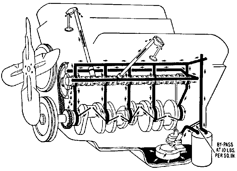

If any one of these passages are blocked from floating crap still in there it would prevent oil to the overhead:
Honestly I am hoping it is just a matter of lifters not pumped up fully. Loosen them all,run it, and let the oil flow freely to the top end.
