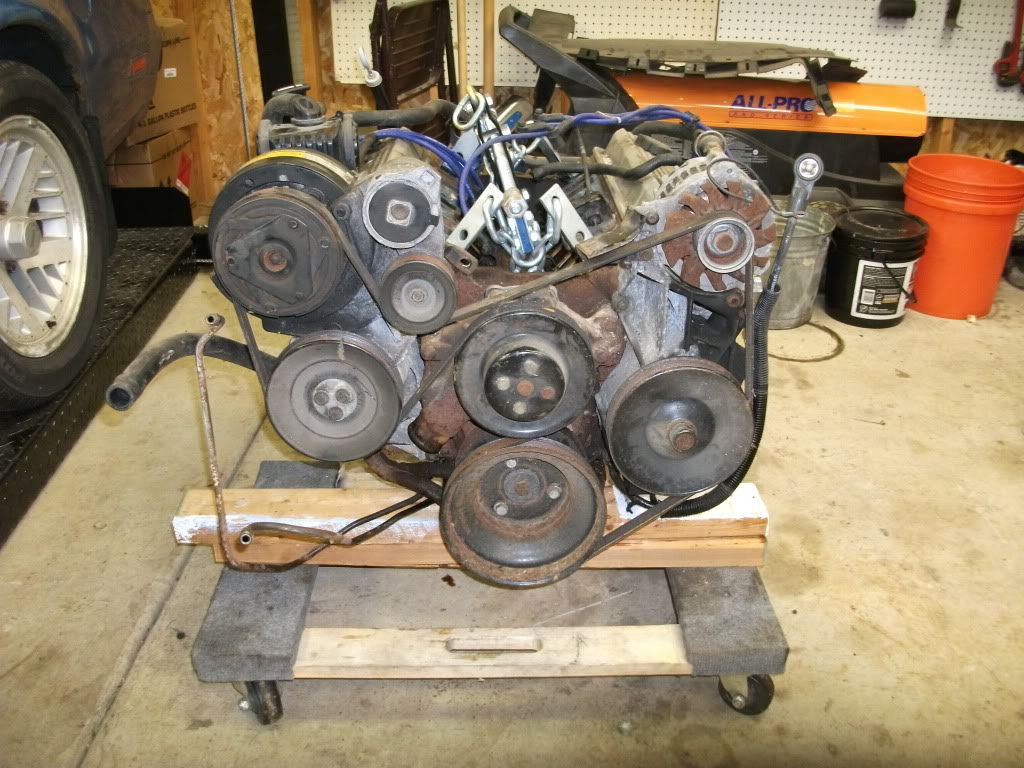

Posts: 28,025
Likes: 2,496
Re: Is removing my engine necessary ?
Rob,
If I were assembling that accessory drive system, I'd go from the crank pulley to the WP to the PSP to the alt to the tensioner to the AC to the AIR and back to the crank. Basically make the belt loop over the PSP (high power draw, 3/4 wrap of belt contact) and slide past the AIR (very low power, doesn't need the loop).
The tensioner would probably even work better done that way.
The tensioner would probably even work better done that way. Thread Starter
cool pics thanks for that.
Mines a non serpentine setup and my AC and emissions crap are long gone, dont need em over here in the UK !
