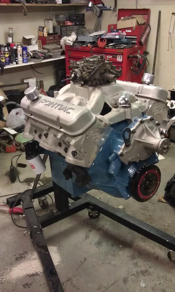

I used POR15 Engine Enamel on my motor. I have about 15k miles on it and it still looks like the day I painted it. They don't have a GM corp blue but they have a Chrysler blue that is pretty close and that is what this is.
I also painted my 461 Pontiac with it.
