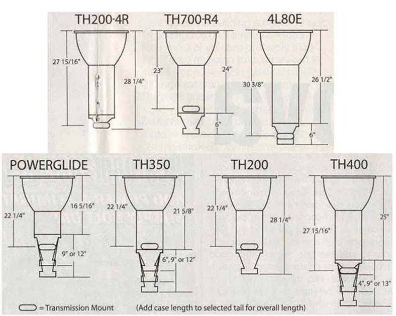

I hope someone can help me out/send me in the right direction. I have an 82 Z28, The engine I put into it came out of a 86 Chevy Custom Deluxe, Along with the TH350 Transmission. I've been told that MOST cars have short shafts, and most trucks have long shaft transmissions and that I would need to have a new driveshaft made. I don't really know how to go about measuring it.
So my question is, is this true? and would a different shaft from a different vehicle fit it?
and how do I go about measuring what I am needing. The crossmember bolted up fine, just like it should have, no adjustments were made, but I was told the extra length is in the tailshaft

If the tailshaft housing is 6" long, you can use your '82 driveshaft. If the tailshaft housing is 9" long, you can use a later 3rd gen driveshaft (the more common ones).
A good reference chart:

So I need to measure the tail shaft, and if it's 6" get the stock 82 length shaft, if it's 9" get the stock late gen 3 length?

sorry to revive this, but I went and measured the shaft this morning, it wasn't the 6 inch tailshaft, it's the 9 inch one. So can anyone tell me the length of a "later model" third gen?
