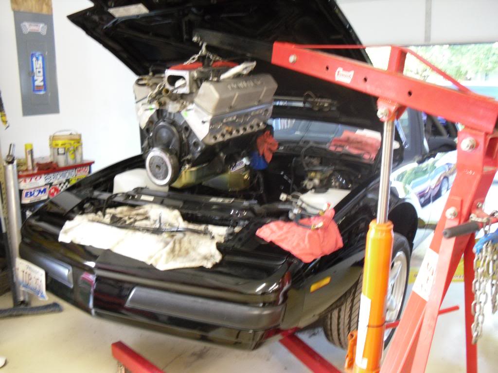

This is how I do it. Car on my lift, hoist on side with hood on. (I have done a buttload of them this way, 500 plus)
IMAGE#1
I can't tell from this angle, is your front end on jack stands? as high as you can get it ?

Re: Dropping Engine and Tranny?
Did you read my post you quoted??
