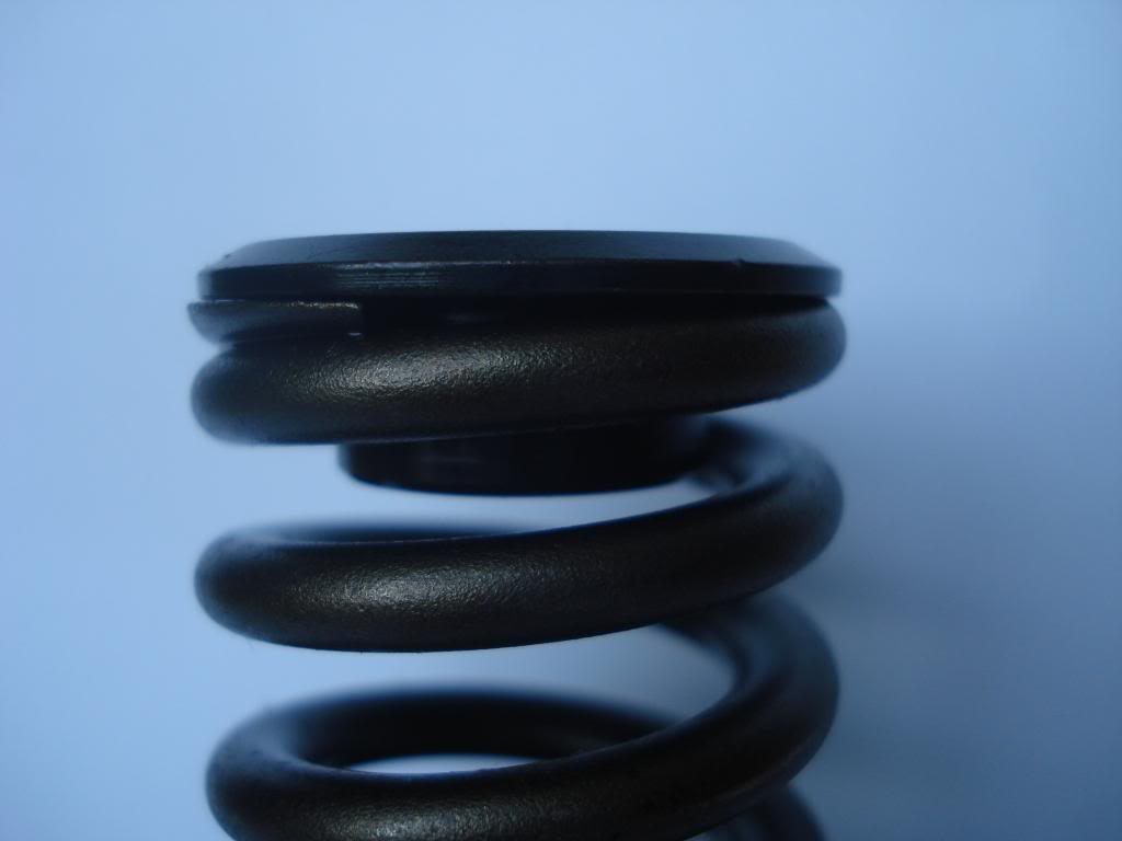

The question is, do I re-use the stock "oil shield" that sits inbetween the spring and the retainer? My guess would be no, since the retainer doesn't fit into the shield perfectly square. Without the shield, the retainer sits really nice and flat. Pics with and without shield attached:

ive been running without them for many years. i think it lightens the valvetrain too.

Yup, ditch them.
You'll need a decent spring shim for the exhaust valves if you remove the rotators..

Any estimate on shim thickness in order to compensate for deleting rotators on exhaust side? Heads are stock 14101081 and have not had any machine work done on the spring seat pockets.
Old Mar 9, 2013 | 12:01 PM
Posts: 28,015
Likes: 2,492
Re: Valve spring retainer question - *see pics*
.090" - .100"
