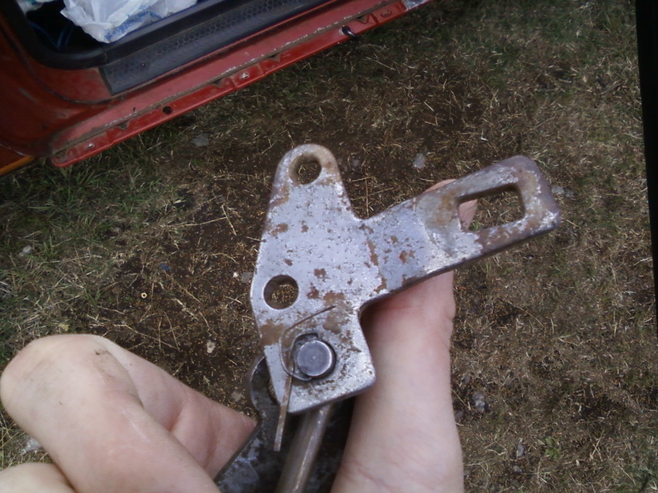

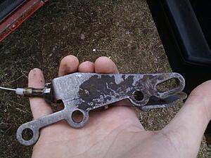

I believe I have this piece: http://www.jegs.com/i/B-M/130/30498/...oductId=751254
Am I going to need this: http://www.jegs.com/i/B-M/130/20462/...oductId=751254
The transmission has a shift lever like this on it: http://www.chevyasylum.com/tech/68nova_198w.jpg

If that's the bracket you have (it comes with the shifter when new), then that's the piece you need.
And, yes, you need that lever if you don't have it.
Any idea what became of the shifter cable?
(BTW, in researching a response for this thread, I realized I couldn't use the bracket I currently have on my TH400 for the 4L80E that's going in to replace it in the '57. So, you did me a service for my own project...)

As for the shifter cable.... unless it is under the car still bolted on somewhere, it is gone. When I bought the car, I saw the shifter, and when loading it on the trailer, I believe the bracket (the piece I have) fell out and I picked it up, it had a piece of metal wire on it, maybe it was what they "used" as the shift cable, I'm not really sure I'll get a picture of it tomorrow or later today and see if you can help me identify it.
