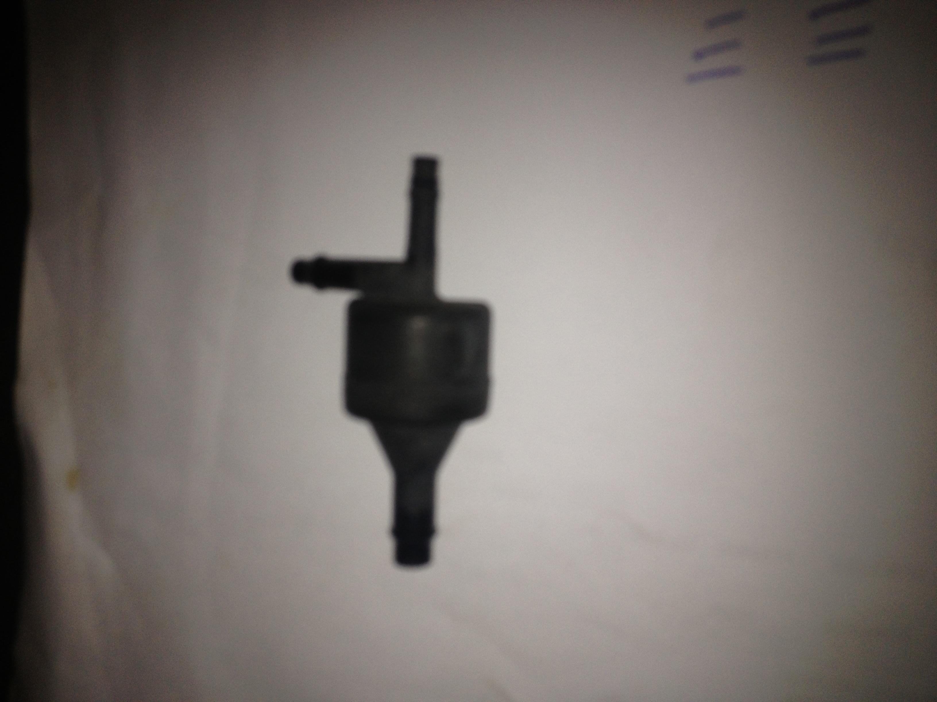

Vacuum lines are hooked up, ( according to diagram ) but in a book I did see a little black thing ( diffuser) that looks like it hooks to throttle body ( idk where other ends hook.)Can't find anything about it. But that is only thing not on engine, the diagram on engine does not show that black thing. I have out new plugs and wires on it

Replaced map sensor as well , the vacuum line are hooked up accord to diagram on car but in a repair manual it show a little black thing they are calling a vacuum damper hooked to throttle body( see attached pic ) idk what it all hooks to and don't know if it is causing prob
if you say that there's no vacuum leaks then that piece shouldn't be the problem. That piece is close to the canister, most people replace those with a T fitting. But I would just double check all the little things first, IAC, TPS, Sparkplug wires for cracks, MAP sensor, when you start the car can you hear any whistling sounds coming from the engine? also make sure your base timing is at 6* BTDC
